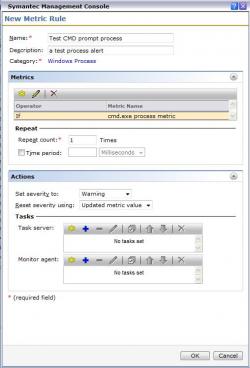

Create a new agent based monitor policy
In the new Monitor policy in the Rule tab click the + button to add a new rule
Fill out a name and description (if you want) . I created a new category for windows processes
Under Actions change "Set severity to" warning
Click on the * under "Metrics"
Click the *new button and select "Windows Process"
Name the Metric, optionally add a description, I changed the polling interval to 30 seconds from 300 and type the exact name of the process and extension that you need to monitor. In this case we will monitor if a command prompt window is open. You can find the process name by looking at the server you want to monitor and looking at the task manager under processes. Hit OK
The new metric will be highlighted, click OK at the bottom
In this window I left the default "none" under statistics.
If evaluating only one instance keep condition set to "equal to". Since I am evaluating 2 instances of cmd.exe in this case, I set it to "Is less than". Keep value type to "constant". Because I want to have an alarm go off when less than two instances of cmd.exe are running, I have set value to 2. Hit OK when you are done
In this window could configure the rule to start a task back up, send out an alert email. I usually leave the alert email to come from the policy when the warning is tripped.
The new rule is already highlighted so click OK.
Apply the policy to a machine or a filter containing machines
Go into the Actions tab. This is where I traditionally send out alerts. Click the Warning tab. If you already have a warning alert click the + and add the warning alert. When done click save changes.
