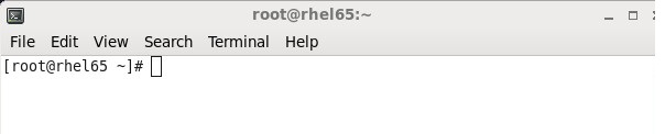

1) On the Linux computer, open a terminal application window
Applicaiton --> System Tools --> Terminals
