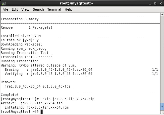

2. Any Java JRE or JDK that was previously installed should be removed to avoid any possible adverse effects. Run the below command to remove it:
yum remove java
3. Press the "y" key when prompted if it is okay to remove any "jre" or "jdk" entries found. If there is no previously installed version of Java, then the below command will explain that no package exists:

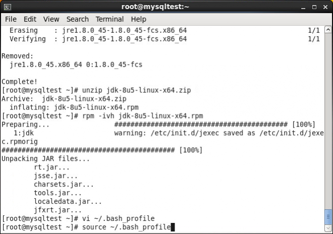

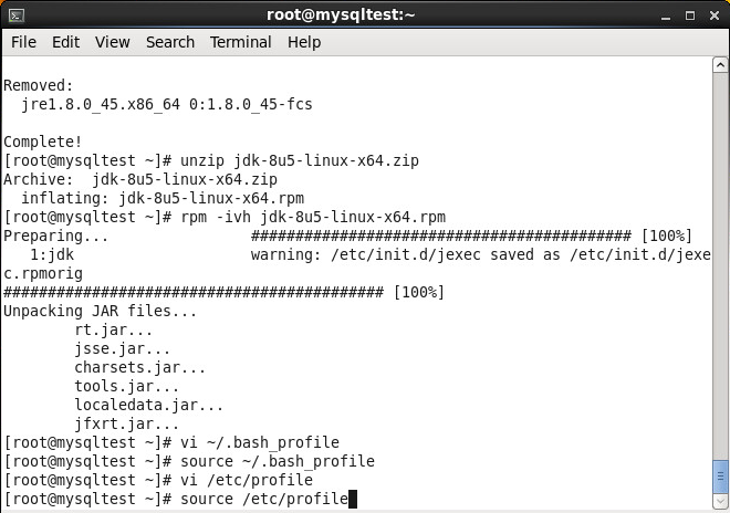

4. Unzip the "jdk-8u5-linux-x64.zip" file from the directory where it was saved.
unzip jdk-8u5-linux-x64.zip

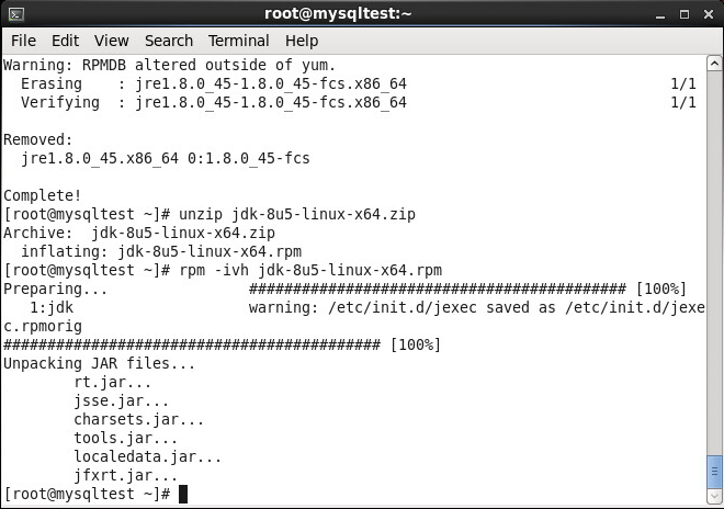

5. Install the new version from the directory where the "jdk-8u5-linux-x64.rpm" is located:
rpm -ivh jdk-8u5-linux-x64.rpm
Set Java JDK's Environment Variables
Once the proper JDK package is installed, The java variables need to be set by using the below example:

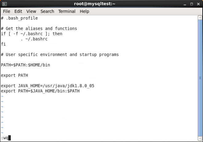

1. Edit the root user's bash profile:
vi ~/.bash_profile

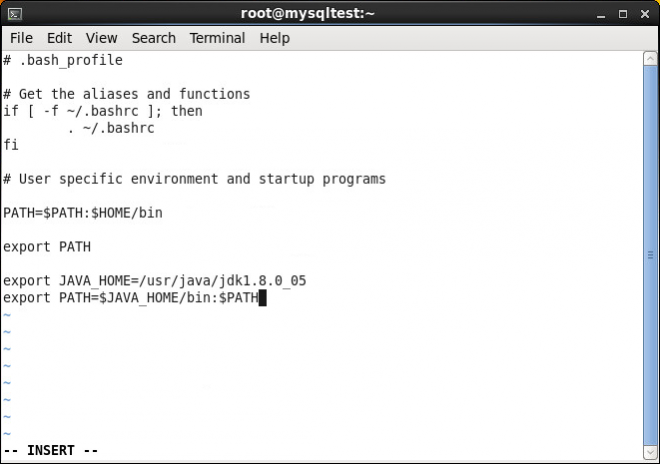

2. Add a new "export JAVA_HOME=" entry at the end of the file (or edit an existing entry) by pressing "i" to enter into "INSERT" mode and set it to the location of the new installation. It should look like the below example:
export JAVA_HOME=/usr/java/jdk1.8.0_05
3. Add another line by pressing the <Enter> key, add the "export PATH=" entry (or edit an existing entry) at the end of the file, and set it to the location of the new installation. It should look like the below example:
export PATH=$JAVA_HOME/bin:$PATH
4. Hit the <Esc> key and type ":wq" exit "INSERT" mode and save changes to the file:
:wq
5. Reset the root user's bash profile:
source ~/.bash_profile

9. Reset the all users' bash profile:
source /etc/profile

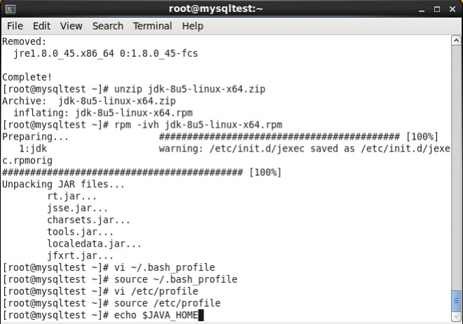

Verify the Java JDK Version and Paths

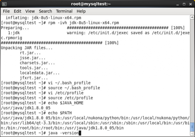

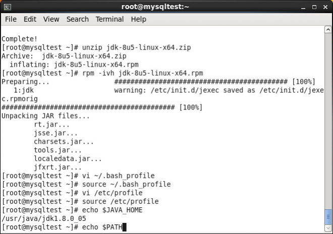

1. Verify the updated JAVA_HOME directory by typing in the below command and pressing the <Enter> key:
echo $JAVA_HOME
2. Verify the PATH to the java executable by typing the below command and pressing the <Enter> key:
echo $PATH

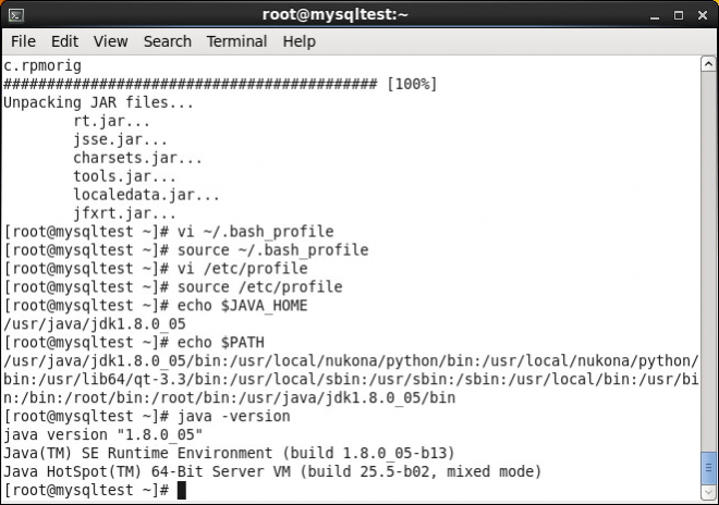

3. Verify the new Java JDK version by typing the below command and pressing the <Enter> key:
java -version
If the responses match the updated Java JDK directory and version, then this process has been completed successfully.
