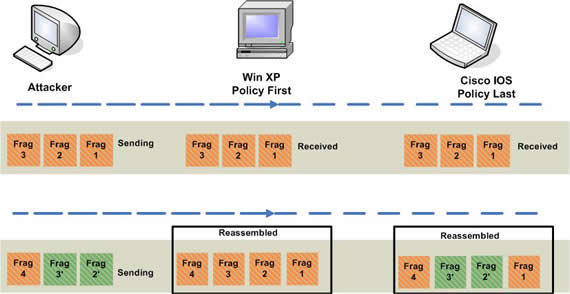

Overlapping fragments
In addition to these attacks, which are based on the fragmentation reassembly timeout, there is another class of attacks based on overlapping fragments. Paxson and Shankar pointed out in their paper titled "Active mapping: resisting NIDS Evasion without altering traffic" [ref 6] that different operating systems perform fragmentation reassembly differently. Based on this model they deduced that there are five different re-assembly policies.
In this paper, we will give a brief description of two of these fragmentation reassembly policies, in particular, the ones named first and last.
First. This is where the operating System favors the original fragments with a given offset. For example, Windows 95/98/NT4/ME/W2K/XP/2003. Last. This is where the operating System favors the subsequent fragments with a given offset. For example, Cisco IOS.
The first and the last fragmentation policy are explained below in Figure 4.
Figure 4.
Figure 4. Windows -XP favors original fragments whereas Cisco IOS favors subsequent fragments.
The attacker carries out the attack by breaking it in 4 fragments. She sends fragment 1, fragment 2 and fragment 3 first, which both operating systems accept. Now the attacker sends fragment 2', fragment 3' and fragment 4. Here the payload of fragment 2' and fragment 3' is different from fragment 2 and fragment 3, respectively, but the fragment offset and the length of the fragment along with other fields in the IP-header remain the same.
In such a scenario, an operating system doing a fragment reassembly based on policy First will do a reassembly on fragments 1,2,3,4 whereas the operating system doing a fragments reassembly based on policy Last will reassemble fragments 1,2',3',4.
The mapping of different operating systems, along with their respective fragmentation reassembly policy, is listed below in Table 1.
