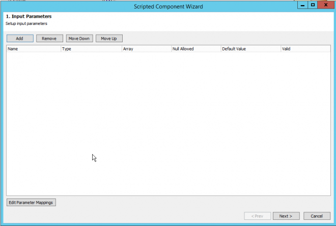

Step 3: Leave the Input Parameters empty and click Next

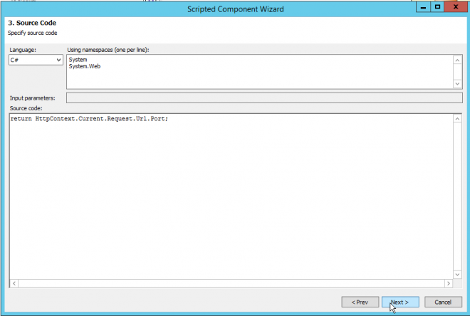

Step 5: Configure namespaces
System
System.Web
As source code enter
return HttpContext.Current.Request.Url.Port;

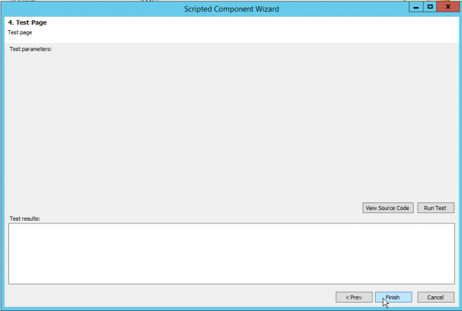

Step 6: Just click Finish.
REMARK: Run test will generate an error.

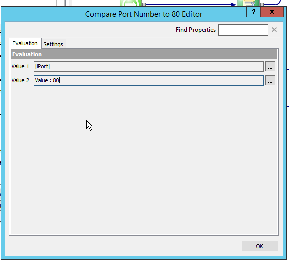

Step 7: Add a compare number component. And Compare the result with port 80 (HTTP)
