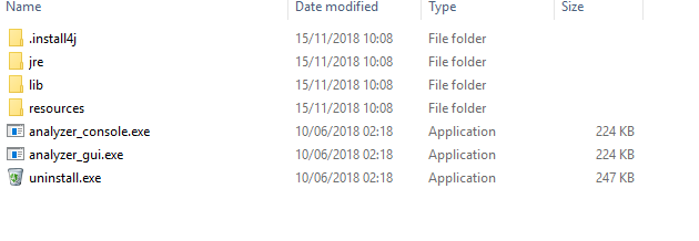

5. Install to a directory of your choice and then browse to the install location.
 File Analyser Folder Directory

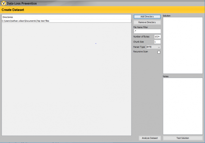

6. Run analyzer_gui.exe
7. Once File Analyser is running select the directory location of your test files and enter .* into the File Name Filter box to show all files.
File Analyser Directory

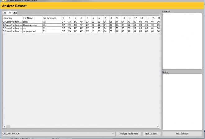

8. Click Analyze Table Data and select the .7z tab to filter out your example .txt files.
7z Analysis Window

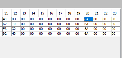

9. We now need to look at each collumn and identify the 'magic byte' mentioned earlier; this can be in the first byte or the last, but will always match the the file type created. For example a password protect .7z will match another password protected .7z; however will not match a standard .7z file.
10. Once reviewed you should have found the below magic byte for .7z (This will be different for all file types)
7z Magic Byte
As you can see in byte 20, there's 2 matches. These matches are for a standard .7z file (5A) and a password protected .7z file (6A) this number is unique to this file type.

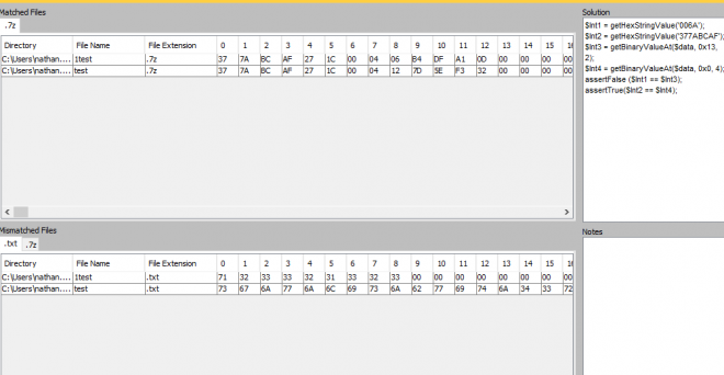

Example of the script working in File Analzer:
As you can see, it has matched the non password protected .7z files as they meet the scripts requirements, and has filtered out to Mismatched the password protected files as they do not meet the script requirements.

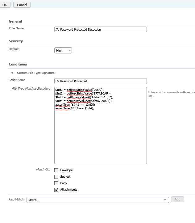

17. Once your DLP instance is back up and running go into an existing policy or create a new and select 'Add Rule'
As you can now see you have a 'Custom File Type Signature' rule option to select
If you do not have this option please review the above steps for enabling or see https://help.symantec.com/cs/dlp15.0/DLP/v48848719_v120691346/Enabling-the-Custom-File-Type-Signature-condition-in-the-policy-console?locale=EN_US )
18.  Insert the relevant information and the script designed earlier:
Custom Rule for .7z
Conclusion: You now have a custom file extension rule operational in DLP, this method can be applied to any file type not just .7z so please use this guide as a reference to what you're trying to achieve.
