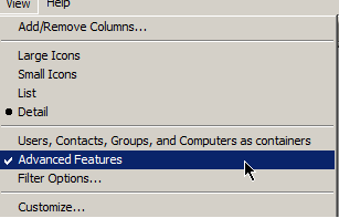

  2. Select View and Advanced Features (if not already enabled)

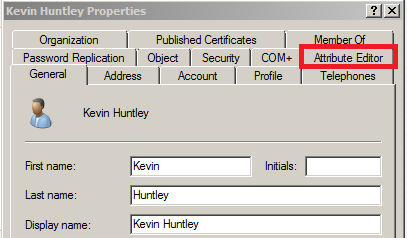

  4. Open the user's AD Properties
  5. Select the field Attribute Editor
  6. Scroll down the fields in the Attribute Editor and find "userPrincipalName"
