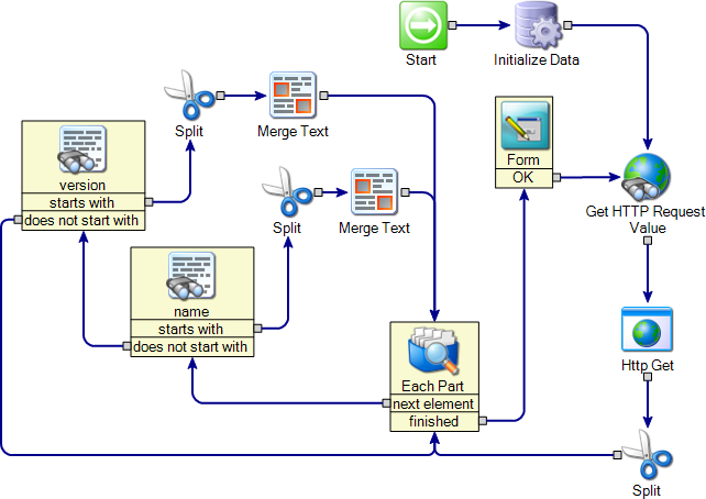

In this post response by reecardo, it’s mentioned that the Get HTTP Request Value component can be configured to return the HTTP_USER_AGENT string.  So instead of doing all the work to parse that string reliably, (see this article to find out why this string response is so convoluted), I decided to instead use that time to learn some more C#.

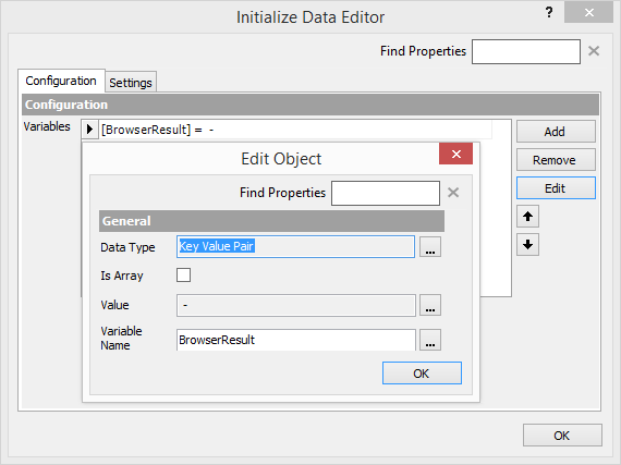

In the Initialize Data component, declare a “Key Value Pair” variable to hold the browser data we want.

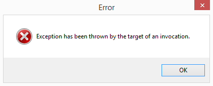

On Page 4, ignore the tests, as the result will not be satisfactory.  The context of this component is expected to be run within a browser, and as such, the test option here will fail.

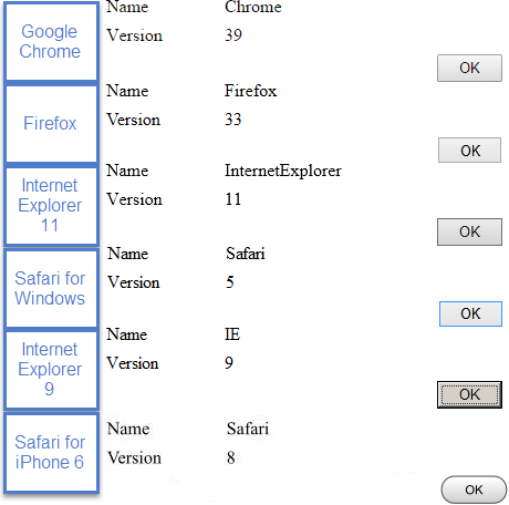

Test the project in different browsers to see the results.
When compared to my original attempt at parsing the returned string from the Get HTTP Request Value, it should be apparent why I prefer this method.
Original (the Http Get component is using an API to return a translation of the HTTP_USER_AGENT string):
Custom C# component:
So the process has been streamlined a bit, and requires far less effort.
