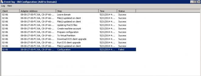

Jun 18, 2015 05:06 AM
Thanks Terry, great guide.
However I am stuck as the point of after the clone task is completed,
I run a standalone config task that renames the PC and adds it to the domain, but this task is failing with
An error occurred on the client but the error file could not be retrieved. on the configuration step.
any help given would be appreciated.

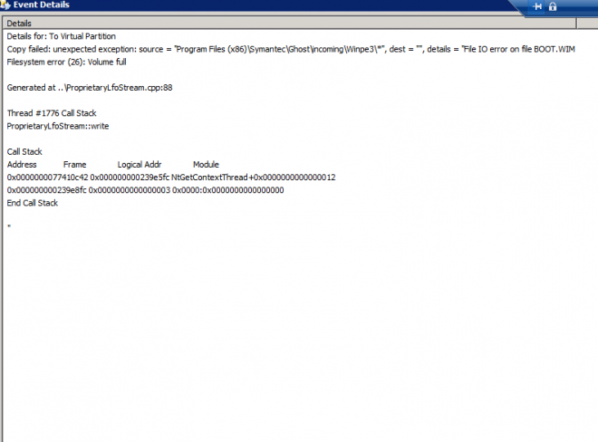

Oct 09, 2014 01:03 PM
    This article has been a great starting point for me. I had to make some modifications for my specific use as well as to be able to use it in the Ghost Console. Using the method described in this article I ran into 2 issue with the console.
     The first was that the console was detecting that the manifest did not have the correct drivers listed for machines I am using. So what I did was first go into the Ghost Boot Wizard and copy the WinPE to a new WinPEtmp. Then I edited the WinPEtmp and added all the WinPE3 drivers I needed, even though they would not work with the original WinPE this method added the correct entries in the driver manifest so that is would detect that it has the drivers. Then I followed the remaining instructions to create the WinPE3 PreOS.
     The second issue I was receiveing had to do with the size of the .wim file. It would error out stating that the .wim file was the wrong one. I received the following error message.
Details for: To Virtual Partition
The File"{manifest}\\Sources\\boot.wim" (size 151MB) is too large for the size (120MB) specified for this PreOS.
So what I had to do was to go into C:\ProgramData\Symantec\Ghost\Template\common\WinPE3\Manifest.txt
Find the following section
path = "{manifest}\\sources\\boot.wim", size = 120}
and change size = 120 to size = 151
After doing that all was well.

May 28, 2014 03:19 PM
Ok we got the PE to boot but when it is attempting to connect the commandline shows the Cert key push but it has the wrong server IP and we tried changing the client from host name to IP but not change. It connects fine when the Clone PC is booted but when it tries to connect to the server for the session it has the wong IP?
May 22, 2014 11:07 AM
2 questions:
first, what step did it error out on (that is covered by the event details)?
second, is this a standalone config task, or is it doing other things too?
i ask because using the new PE, i cannot clone and config in the same task unless i booted to the PE using the USB key
May 21, 2014 04:52 PM
Terry BU,
Thanks for the documentation. I successfully imaged a machine via the console. However, I am getting the following error while doing a Configuration task. "An error occured on the cleint but the error could not be retreived" Any Suggestions?error.jpg
May 15, 2014 01:24 PM
Hi Terry,
This solution does not fix the "Volume Full Error". I tried changing the manifest files both on Win-PE and Winpe-512. Any other suggestions?

no, BUT!  there is a previous article from Symantec here:
https://www-secure.symantec.com/connect/forums/volume-full-error
that talks about getting that error and how to solve it!  seems to be an easy fix!
Apr 14, 2014 09:55 AM
Hi Terry,
       Have you seen this error before. I am trying to pull an image from a machine with the new Winpe3 Boot.WIM I copied and I am getting this error. VOlume Full.My BOOT.WIM file is about 143MB.volume full.PNG
Apr 11, 2014 03:43 PM
