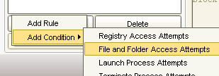

6) At the bottom, under "Rules" click the "Add..." button, then "Add Condition", finally selecting "File and Folder Access Attempts".
