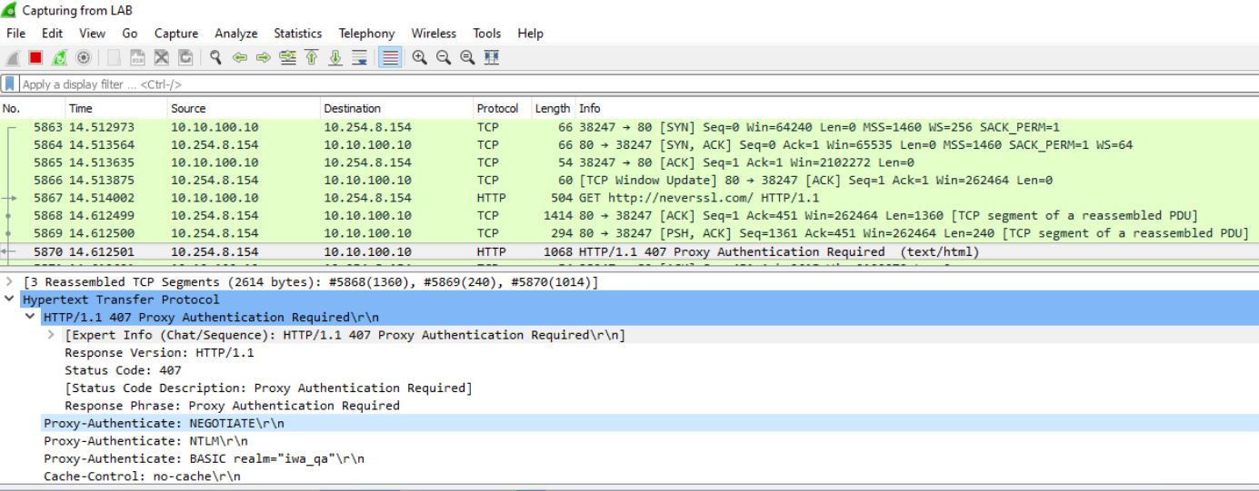

In the pcap on the client I see that the proxy is offering negotiate. As you can see Kerberos is not listed as the health check is down:

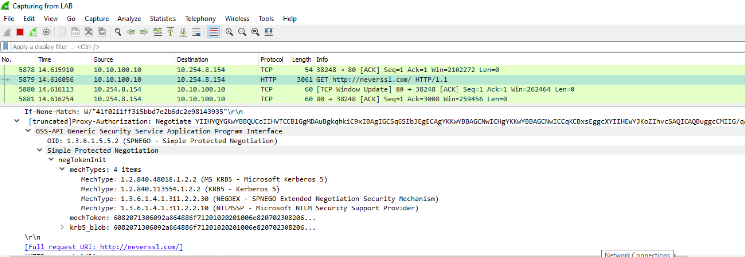

But I think the client is sending the Kerberos ticket anyway:

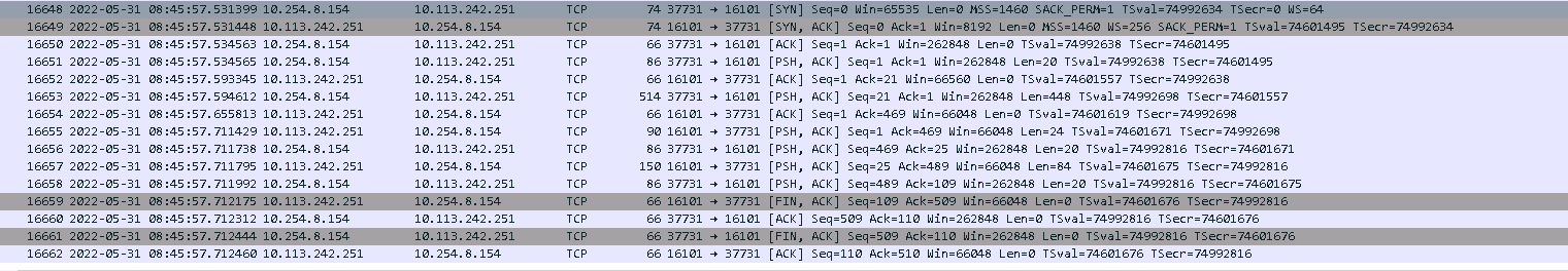

I don't think capturing between proxy and DC will have any benefit as that is proprietary over 16101.

The pcap looks like a transparent setup.
I think what you are seeing in the pcap is expected and the client showing it's using Kerberos is a good sign.

Running the pcap from the Proxy to the BCAAA and from the BCAAA to the Proxy needs to be checked

Capture between proxy and BCAAA looks good. I don't think there is any issue if NTLM authentication to the same DC works fine.

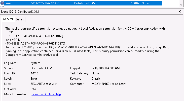

I found the following logs on the DC related to the BCAAA user, thrown each time I restart the BCAAA service:
I tried to fix this but I was not successful. I don't know if this error is RCA for my issue. Also, MS resources are confusing as some are saying it can be ignored and some it should not.
I still think there is something wrong with the DC. I'm now trying to setup brand new DC to exclude any adjustments I did in the past on the existing DC.

From the documentation and the pcaps it looks like Kerberos is being used.
I don't think you see it on the Proxy pcap as the documentation states it's behind the scenes.
You see it from the Client to DC side pcap which yours shows the requests and the ticket.
In the Client pcap you had if you enter kerberos in the filter field at the top, do you see the requests, responses and the GET?
Also is there anything odd seen in the pcap if you select "Analyze > Expert Information" from the menu at the top?
