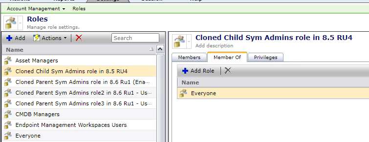

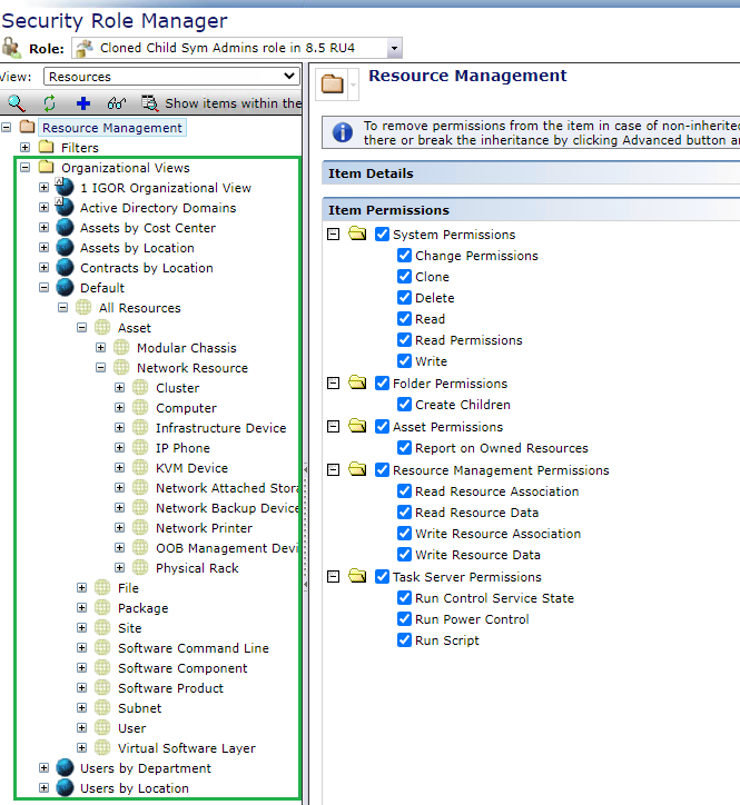

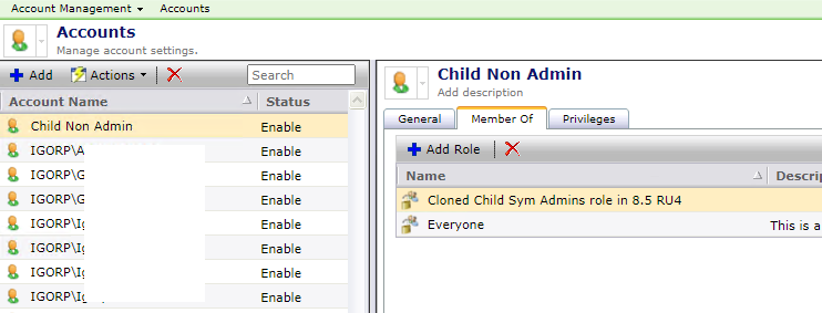

    Good morning Pablo Llorente!
    Could you please provide information:
    1. How this security role was created? Cloned from default "Symantec Administrators" role or from any other default role?
    2. What restrictions has this affected security role? Otherwise this role can see all default Org Views/Org groups and resources
    For example, how looks accessible Org groups, resources for this Role
    3.
    Pablo Llorente: We have removed the accounts and created them again and the problem has been solved.
    IgorP: Looks like I'm too late.. Would be useful to check where Accounts were "Member of" other Security roles
    For example, check "Member Of" and "Members" tab for affected Security role
    Also check "Member Of" for affected "Account"
    This case isn't same as described here https://community.broadcom.com/symantecenterprise/discussion/filters-new-computers-and-installed-agent#bm9ff586e8-25b8-410f-b707-8d0b2e745364 ?
    Many Thanks!
    IP.

    I can't reproduce this problem. All custom roles cloned from "Symantec Level1 Workers" or "Symantec Administrators" role, set same permissions for same Items, resources (like it is shown on pictures from attached .pdf), after upgrade from 8.6 RU2 to 8.6 RU3 release, all custom roles (accounts in) have same permissions and see only allowed Items, Resources, Filters in SMP Console.
    Assume that maybe these affected accounts/other roles were added in not required "Security Role" therefore they saw all other items in console.
    Please check "History" for affected accounts and roles
    Example, when you right click on account or role to see "Resource Change History"
    Best Regards,
    IP.
