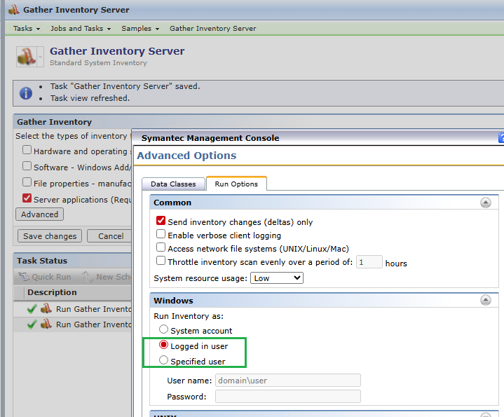

    Hi Jeff Stanton!
    Open "Advanced" settings and try to use a "Logged in user" or specify user manually.
    Best regards,
    IP.
  • 3.  RE: Server Inventory Agent Not Collecting Database Info on Some Servers
    Posted 5 hours ago
    Hi Igor.  Thanks for the reply.  I tried selecting both "logged on user" as well as a specific named user and that did not work either.  Do you have any other suggestions?
