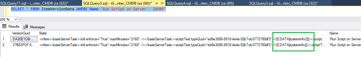

    If I correctly understood your question, Server or client tasks "script" itself is in "State" column <![CDATA[]]
    As example of my "Run script on Server" task where command is 'systeminfo2'
    EXECUTE spLoadItemByGuidAndVersion @itemGuid='GUID of required Task', @Culture=N'en-US', @version=-1
    "ItemVersionData' sql table also contains exact Script task "command" data, but need to known required version of this task.
    Own custom tokens can be created on this page
