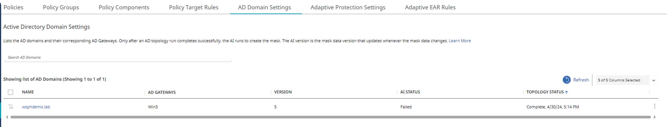

    same here topology completed but AI Status "Failed"

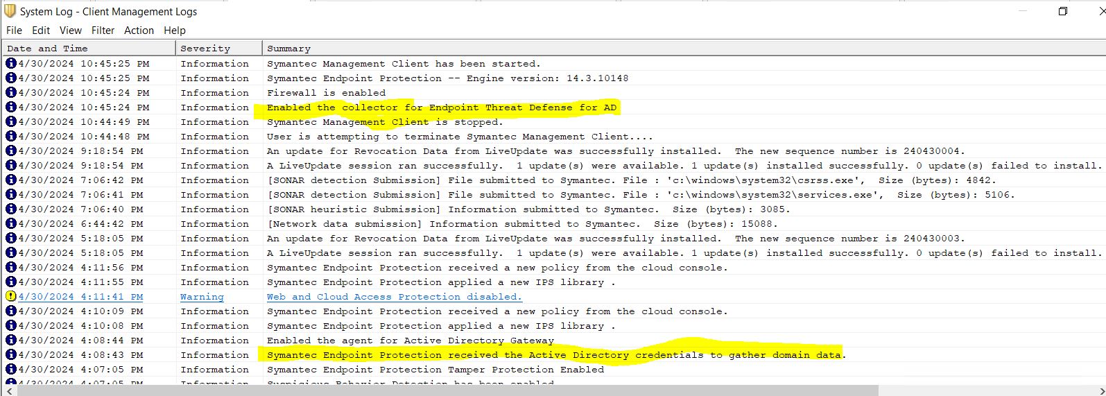

    Posted Apr 30, 2024 10:56 AM
    support configure the missing permission "User Rights Assignment as
    Log on as a batch job" still got the same result even I tried another vm.

    This is TDAD onprem, I thought this was TDAD cloud.
    Regardless, if your topology competed successfully, then you do not have a permission issue with the service account.  The breakdown is happening with the AI.  It can not process the topology information to create the mask.  This maybe because there is something unexpected in the AD tree data (special characters or too long a field name) or because of a permission issue with reading the AD tree that resulted in missing data.  Support will need core logs off the TDAD core server during the time that the AI failed to generate.
