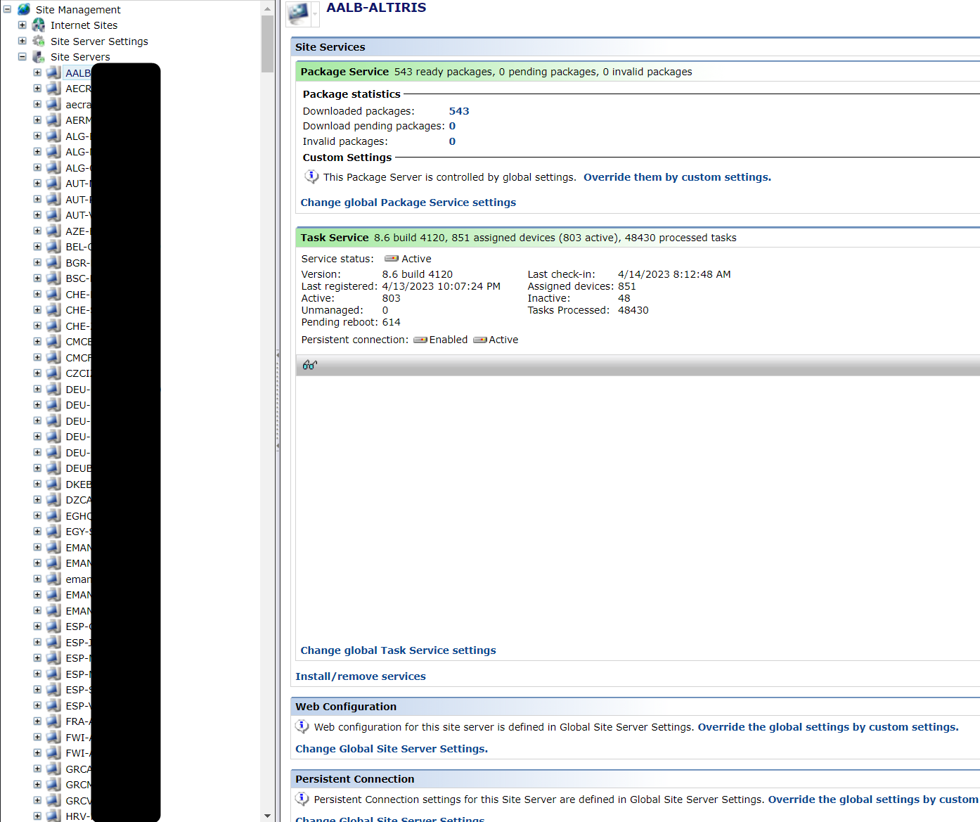

    Within our altiris we have more than 100 Site Servers corresponding to different countries. We are managing the Site Servers with IP ranges, hence clients coming from "country Spain - Location Madrid" will contact "Site Server Spain  - Location Madrid". Otherwise we could have clients connecting with Site Servers belonging to a different country facing several network issues.
    The problem is with clients that have any IP unassigned, meaning that the IPs are not within any IP range that has been previously assigned to any specific Site Server. In this case, the Altiris behaviour is to assign to those clients the first SIte Server from the Site Server list (ordered alphabetically).
    In our case, the first from the list is one Site Server that has been renamed with "AA_" in order to capture in a controlled manner all the unassigned clients, but the second of the list would be one small site server in UAE, with very low bandwidth.
    We can see how this first Site server "AA_.." has more than 1000 clients with IPs unassigned. In case that site server goes down one day, all the clients will go to the second one in the list, the UAE mentioned one.
    Question is: Is there any way to configure the behavior of unassigned clients, choosing the SIte Server where those clients should be assigned automatically?  The solution of renaming Site Servers adding "AA_...", "AB..." is not so Professional and we are in conflict with naming conventions of local servers...
    Thanks a lot in advance for your help, I'm sure that other companies have the same issue in their areas... so maybe it could help many of them.

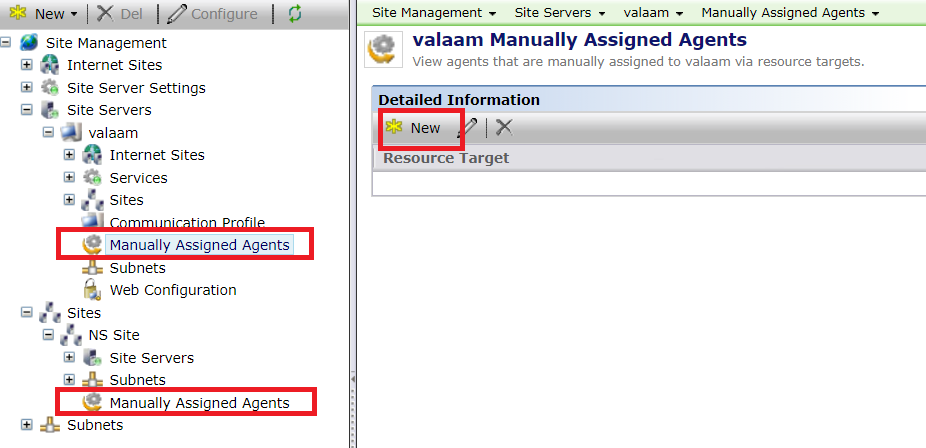

    Here I assume you mean "agents not assigned to any site via subnet". Then one may assign agents to a site or a specific package server  via Manual Assignment  mechanism - see below (it is required to create a dedicated target of machines).  If it is Site Manual assignment, the machines will be served by PSes located in that Site.
    However in the manual assignment case one should ensure all the packages that  potentially should be delivered to the manually assigned agents are stored on the assigned PSes as well. Dependent on you package assignment settings you must either assign a package to that Site via manual prestaging or assign packages to "All Package Servers" (which is probably an overkill).

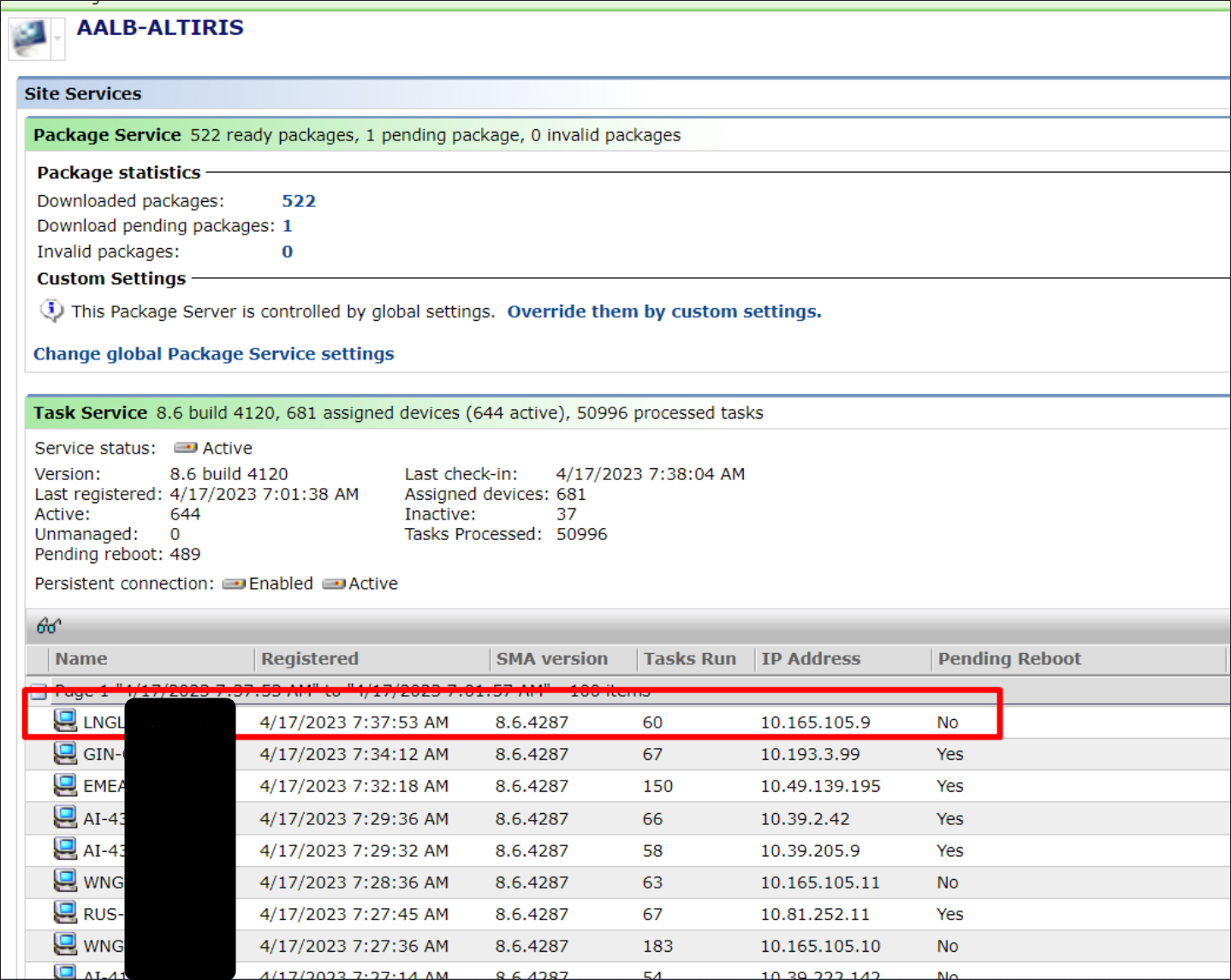

    Let me add some screenshots:

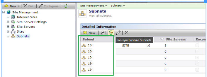

    1st Case - Unassigned IPs: IP range 10.48.202.0/24 (unknown IP range so not assigned to any Site Server)
    Where those clients are going?
    and AALB-ALTIRIS Site Server has manually configured the following IP addresses:
    without any target assigned manually:

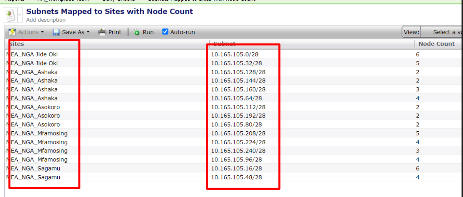

    2nd case: Assigned IPs that are goiing to the first Site Server when the assigned one is not available
    Same screenshot:
    Clients coming from: Russia, Nigeria, UK, Ginea, Egypt, Spain, Switzerland.... going to this first site server, not other from the list. All of those clients have site servers located closely in terms of network, of course, but are contacting to this particular one. Lets take as sample the first cleint, a Nigeria PC:
    The client has the AALB-Altiris server assigned: 10.165.105.9 is the IP
    that IP corresponds to IP range 10.165.105.0/28 assigned manually to Nigeria Oki Site Server:
    But as the serer was off in a particular moment, the clients arre going to the firs of the list.
    The second server from the list, the UAE one only has IPs corresponding to UAE and the same with the rest of servers.

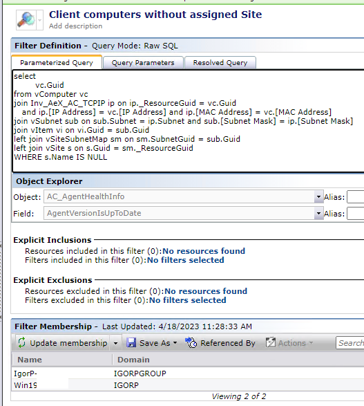

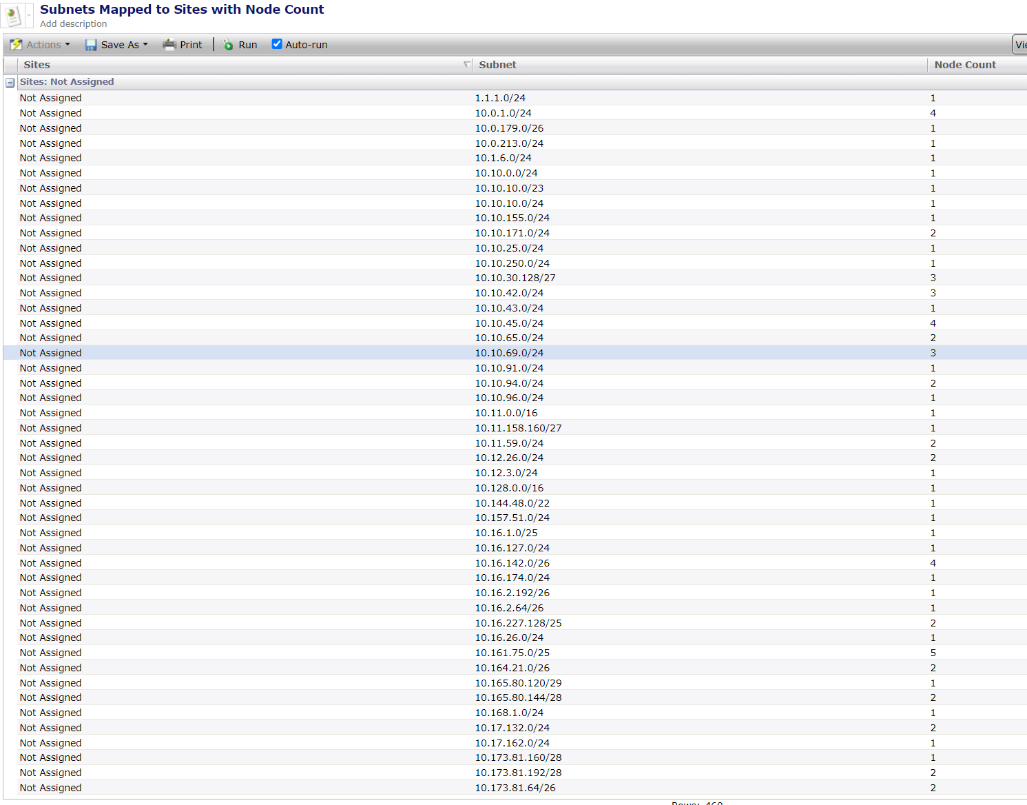

    On the other hand, I think that is a good idea to create a target detecting dinamically the IPs not assigned and adding that target to the Site sever that we decide. Could you please help with the bet Query for the filter? COuld be the following one?
    select
       isnull(s.Name,'Not Assigned') as Sites
       ,vi.Name as [Subnet]
       ,COUNT(*) as [Node Count]
    from vComputer vc
    join Inv_AeX_AC_TCPIP ip on ip._ResourceGuid = vc.Guid
       and ip.[IP Address] = vc.[IP Address] and ip.[MAC Address] = vc.[MAC Address]
    join vSubnet sub on sub.Subnet = ip.Subnet and sub.[Subnet Mask] = ip.[Subnet Mask]
    join vItem vi on vi.Guid = sub.Guid
    left join vSiteSubnetMap sm on sm.SubnetGuid = sub.Guid
    left join vSite s on s.Guid = sm._ResourceGuid
    WHERE s.Name IS NULL
    group by isnull(s.Name,'Not Assigned')
     ,vi.Name
    order by isnull(s.Name,'Not Assigned')
     ,vi.Name

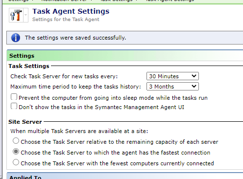

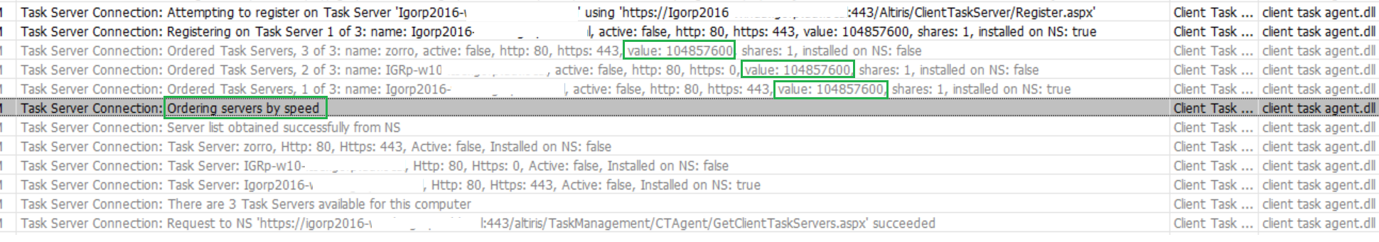

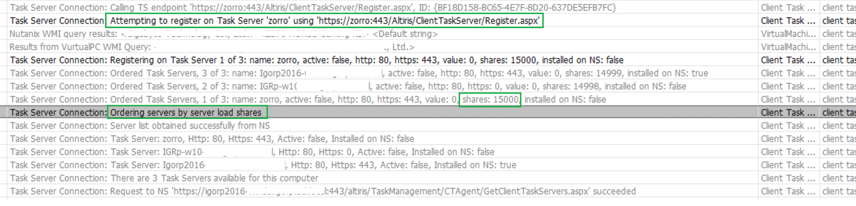

    Hi Pablo Llorente and Jeff Stanton!
    Jeff Stanton: Clients within subnets that we are not notified of are being assigned to the first site server in our list...alphabetically.  It used to be assigned to the site server in the same subnet as the SMP (which was ideal), but I believe back when 8.6 came out, that changed and they began to be assigned to the first in the list.
    IP: I used clean installed client 8.6 RU3 (This client computer is from subnet that isn't included in any existing Site(s) on NS where Task Servers are running).
    According to functionality, Client Task Agent asks NS to offer list of available Task Servers and then order them by their available shares.
    As result we see that CTA got Task Server for registration where more free server shares (Not alphabetically)
    This is a default setting which is used by CTA to register with available Task Servers

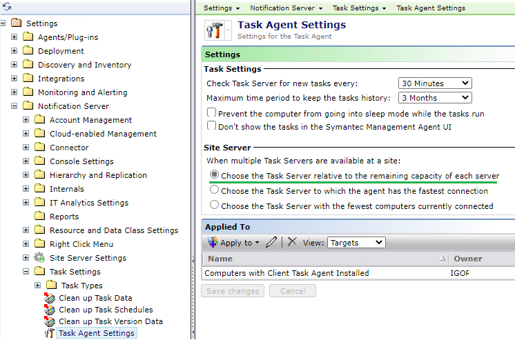

    Note:
    By default, new clean installed Symantec Management Agent on client computer, will attempt to register Client task agent with task servers, using "Choose the Task Server relative to the remaining capacity of each server" option (if this client computer didn't yet receive client policies but "Task Agent Settings" policy has another option enabled)
    In case if there is another option enabled in "Task Agent Settings" policy, then this new installed client computer must refresh policy to receive these settings, then CTA will act according to set option for further registration with Task Servers
    2. Pablo Llorente: But the idea about the target could be good
    IP: Here is your modified SQL Query to create a filter and see list of computers which do not have any Site assignment by their subnet(s)
    SELECT
        vc.Guid
    FROM vComputer vc
    JOIN Inv_AeX_AC_TCPIP ip ON ip._ResourceGuid = vc.Guid
       AND ip.[IP Address] = vc.[IP Address] AND ip.[MAC Address] = vc.[MAC Address]
    JOIN vSubnet sub ON sub.Subnet = ip.Subnet AND sub.[Subnet Mask] = ip.[Subnet Mask]
    JOIN vItem vi ON vi.Guid = sub.Guid
    LEFT JOIN vSiteSubnetMap sm ON sm.SubnetGuid = sub.Guid
    LEFT JOIN vSite s ON s.Guid = sm._ResourceGuid
    Note:
    1. Custom filter which is used in custom resource target, will be updated by "Delta Membership Update" scheduled task on NS only if this resource target is included in any existing and enabled policy. Otherwise resource target will be fully updated by next "Complete Update Membership" scheduled task on NS.
    2. In case if there are new subnet(s) appear in NS database from new arrived client computers basic inventory, they will be populated on "Subnets" page only after default scheduled task execution "NS.Package Refresh.{bd6bf880-bfae-4dad-b746-e8be99f3b8a8}" or user can manually force subnets synchronization (If synchronization isn't yet done for new arrived subnets from new client computers without Site(s), then custom filter will doesn't populate these new subnet(s) for new client computers without site assignments)
    Best regards,
    IP.
  • 10.  RE: Clients with an IP unnasigned to any Site Server
    Posted Apr 18, 2023 08:50 AM
    Thanks a lot Igor, as usual.
    Our configuration is exactly the same as yours, identical, so nothing to
    change there. I think that the Site Server selection is not based on speed,
    because computers from Nigeria should never go to UAE or Spain.. yuu know.
    In fact, as I said, all unassigned are going to the first Site server, no
    others.
    Thanks for the SQL Query. I have added in the filter the exclusion of
    computers with '192.168.%' because those usually are computers for people
    working from home, and those should connect to our site server dedicated
    for CEM connections.
    Thanks again, and keep in touch!

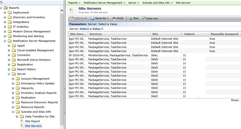

    Also here is detailed information about how Client Task Agent and Task Servers registration works
    https://knowledge.broadcom.com/external/article/150990/client-task-agent-connectivity.html
    "Site Servers" report shows information, what Site Servers are assigned for "Default Internet Site" to serve CEM agents with different subnets
  • 12.  RE: Clients with an IP unnasigned to any Site Server
    Posted Apr 19, 2023 10:33 AM
    Thanks again Igor. I think that the connection method is failing at least
    in our case as we have previously explained and demonstrated. None of the
    three options described explains the nehabiour in our platform:
    - *FewestComputers -* Select a task server based on the number of
    connections
    - *FastestConnection *- Perform a ping test on the task servers in the
    list to find the fastest connection relative to the CTA
    - *AvailableCapacity *- Select a task server based on the shares
    assigned for each entry in the returned list
    As all clients are going to the same Site server and the only reason is
    that is the first of the list, always. If Today I added a new server in the
    French West Indies (very bad bandwidth due to the topology and devices with
    low capacity) and I renamed it as AAAAA_Server, all unassigned clients will
    go there.
    But in any case the workaround is ok for us, so we can control the problem.
    Keep in touch!

    Hi Igor,
    about this point :

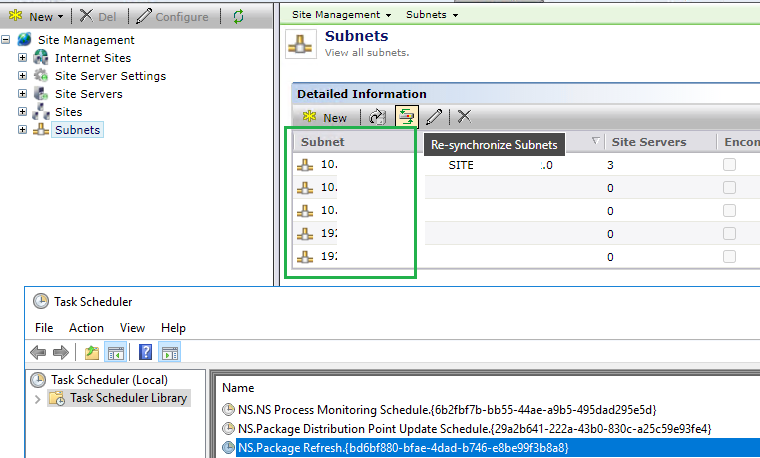

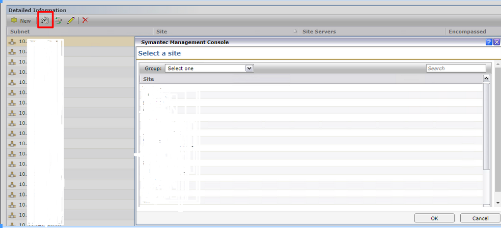

           Before "re-synchronize subnets," if we could have some opportunity to link those new subnets with sites based in batches, the effort to fix the collateral effects probably will decrease. Unfortunately, the interface "assign to site" is very simple and doesn't permit the use of targets, for example, to extract subnets and link with sites manually created.
    Do you know another way to make the same using queries or the ASDK?
    We are talking about thousands of new subnets; in that case, that approach can decrease a herculean manual intervention.
    Thanks in advance!

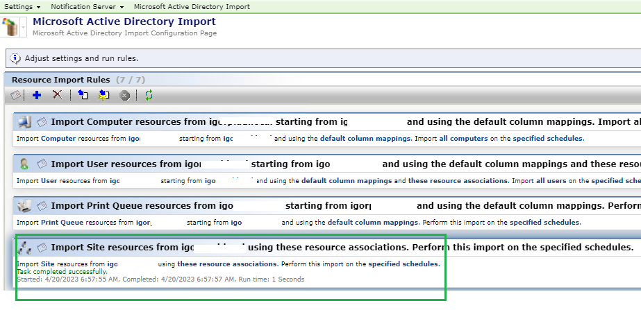

  • 15.  RE: Clients with an IP unnasigned to any Site Server
    Broadcom Employee
    Posted Apr 24, 2023 12:15 AM

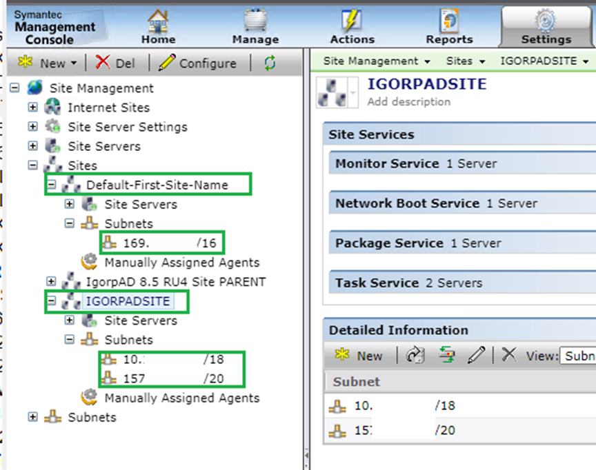

    Hi Jose! (we already discussed about this, I'll just put here that answer)

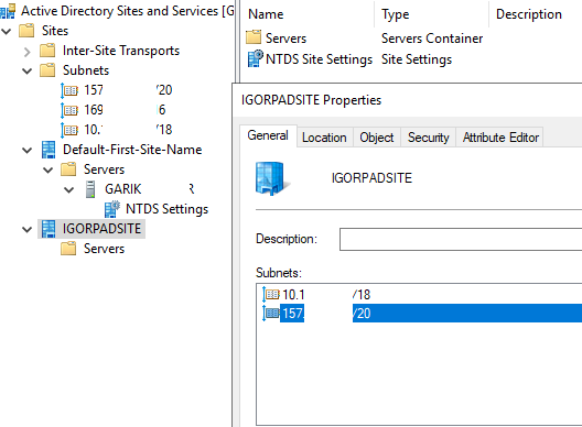

    I understand your case, but unfortunately there is no such automated, ASDK way to acomplish this.
    But if you have Active Directory with some domain controllers in and you have there all existing subnets assigned for correct Site, then scheduled "AD Import Site" rule will automatically import all Sites with their subnets and each Site will automatically has assigned subnets for it.
    As example
    AD data
    As result, now I have all required Sites with their subnets assigned in SMP
    Or if you have a Sites and subnets schema (data source) like csv file, etc which is time to time updated with latest schema of sites/subnets, then it is possible to try to use a "Data Connector" functionality which will use updated .csv with latest information and will import/update Sites and subnets in NS database
    Info about data connector functionality to try implement this:
    https://knowledge.broadcom.com/external/article/181748/how-to-create-a-data-connector-import-ru.html
    https://knowledge.broadcom.com/external/article/181160/how-to-use-data-connector-to-import-data.html
    Best regards,
    IP.
