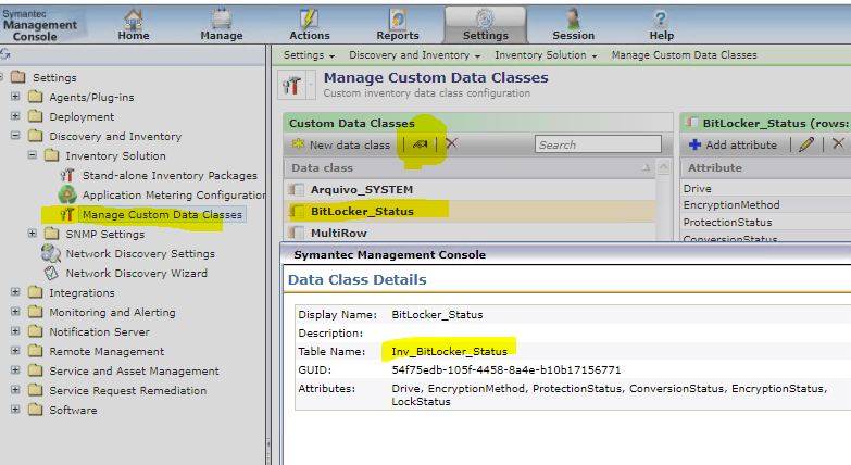

    The Key and Required fields can help with SQL performance when you have a large set of inventory data, but the trick is if Key is set to YES, then only one row of data in the custom table (data class) can have a certain value. So if any of the collected inventory fields may be the same on two or more computers, set the Key to NO. For Required, I believe the behavior would be if one of the fields was blank, the rest would not be written, so setting it to NO would ensure you still have one or more rows of data for each computer.  For recovery key, this is likely unique for each computer, so it would be optional to set the Key value to YES.
    For the report, navigate to Reports > All Reports and right-click the folder you want to store the report in (or create a folder first, also a right-click option) and select New > Report > SQL Report. Then select the new report on the left pane and then click the Edit button on the right pane. Remove the default query and you can create a simple or more complex query for your report. The simple report is just:
    select * from <name of custom data class>
    You can find the name of your custom data class by highlighting it in Manage Custom Data Classes (where you created it) and clicking the hand icon in the Custom Data Classes menu bar. In my example, the custom data class is Bitlocker Status, so with underscores replacing spaces and a prefix of Inv_, the name of the table to query from is Inv_BitLocker_Status. For the recovery keys, just select that custom data class.

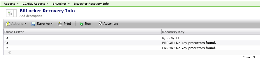

    Posted Dec 21, 2022 04:20 PM
    It seems this VBScript to pull the BitLocker Recovery Key is instead giving me the TPM PCR Validation Profile according to a co-worker of mine.  I changed nse.AddDataClass to match my custom data class GUID so I must be missing some other mod in the script or perhaps something in my custom data class.
  • 16.  RE: BitLocker Status
    Broadcom Employee
    Posted Dec 21, 2022 05:01 PM
    Getting the script to function without error and getting data into the database is the easy part. The logic and collection of desired data in the script is another story. If your script runs without error and puts data into the database, that part is working. It may be the wrong data, but from Altiris standpoint, everything lines up. I can recommend searching to see if anyone out there has done it with VBScript or PowerShell, and you can test locally to make sure, then format the script to return data to the database.
    That said, the line in the script getting the data is:
    oShell.run"cmd /K manage-bde -protectors -get """ &objitem.driveletter& """ >C:\keys.txt & exit",0,True
    The script then reads the file (C:\keys.txt) and then puts any data in the file into the NSE for sending back to the DB.
    This article describes the command run from within the script (manage-bde -protectors -get) and looks to me to be getting recovery key method and ID data.
    https://learn.microsoft.com/en-us/windows-server/administration/windows-commands/manage-bde-protectors?source=recommendations

    After looking at the BitLocker recovery key script from the community post more carefully, I realized that the Loop within it only pulls the last line of the manage-bde output.  This won't fly if TPM is also enabled on the given machine; which explains why 1 computer we were testing the vbscript on wasn't giving the BitLocker password from the manage-bde command since the desired data is about 2/3 down the output that had both BitLocker and TPM passwords.
    A colleague sent me code to modify the loop so have yet to test it but in the meantime, could use some help figuring out how to get the "computer name" field into my custom SQL report as a simple query only gets me the fields in my screenshot, below.
