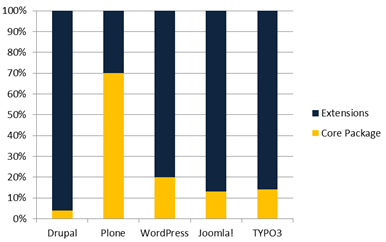

The studies’ main focus lies on the open source content management systems Drupal, Joomla!, Plone, TYPO3, and WordPress. The number of different vulnerabilities publicly disclosed for these systems were analysed and counted. On average, 76% of all identified vulnerabilities were located in extensions or add-on modules that can be installed on top of the core package of the application. Administrators often forget to update add-on modules as well whenever the main system is upgraded, thereby leaving them vulnerable. Nevertheless, people should not resign from using add-on modules as they can offer important functionality. For example, not all CMS have a password brute-force protection, like a delay or CAPTCHA. This can be added by extensions and will definitely help against attackers who scan the Internet for users with weak passwords.
Figure 1. Location of the vulnerability in CMS
