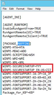

4. Edit the original WinPE10x64.ini File and scroll down to the Section [PACKAGE MAPPING] and add the following to Lines to the Section
Optional: The same steps need to be done for WinPE10x86.ini File if you want to add Bitlocker support for WinPEx86.
This will add the WinPE-Securestartup and the appropriate Languagepack. If you only add WINPE-SECURESTARTUP managing Bitocker with manage-bde.exe command will not work!!!
Curious why we are using YYY and ZZZ? Here is the explanation:
WINPE-SECURESTARTUP requires WINPE-WMI if you are trying to add WINPE-Securestartup before WINPE-WMI it will fail. So to make sure WINPE-WMI is already added to the WINPE Bootfile we have to use the alphabet to accomplish this. So (WINPE-)WMI will be added to the Bootfile before YYY and ZZZ (which are the short names for WINPE-Securestartup and WINPE-Securestartup_EN-US).

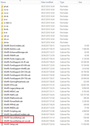

Manage-bde.exe command is included in the WINPE-Securestartup.cab File. You can find these Files on the SMP Server in a Folder called:
<Install Drive>\Program Files\Altiris\Deployment\BDC\waik_winpe10\Tools\PETools\amd64\WinPE_FPs
Go to the folder en-us and copy the File called: WINPE-Securestatup_EN-US.cab to D:\Program Files\Altiris\Deployment\BDC\waik_winpe10\Tools\PETools\amd64\WinPE_FPs
Take a look at the screenshot above.

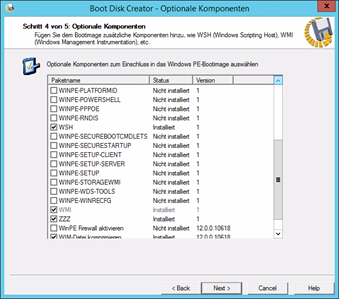

Please allow a selection of packages when you are creating a new Preboot Environment like this is currently available when you manually run Bootwiz.exe
If you run Bootwiz manually, you will see a list of additional Components to install.
When creating new Preboot Environments allow the selection of possible WinPE Add-ons – this is far easier then modifying *.ini Files!!!
