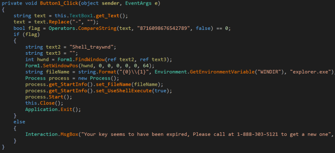

Fortunately, further analysis revealed that the malware author left the unlock code in plain sight without using any obfuscation techniques (Figure 2). The malware itself is simplistic and does not contain any connections to a command and control server.
Victims of this threat can unlock their computer using the code: 8716098676542789
Figure 2: Unlock code 8716098676542789 can be found within the source

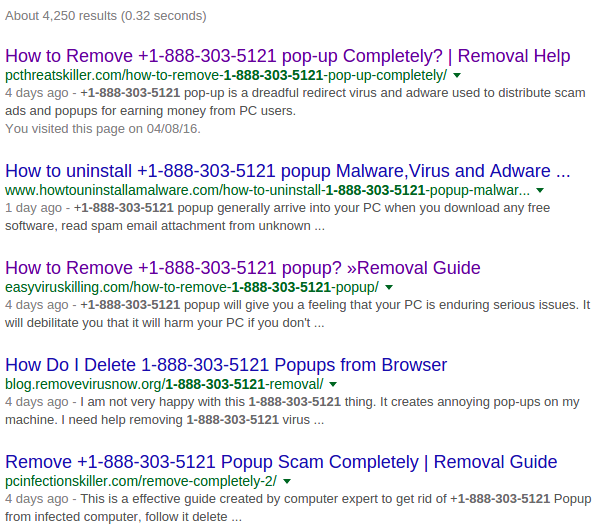

Victims with good instincts or intuition will probably perform a search on the toll-free number to see what the web has to offer. Someone has clearly taken advantage of this attack to offer questionable forms of help. A cursory search on the web for 1-888-303-5121 reveals dozens of sites (Figure 3), which appear to have been created by affiliates, and which try to appear as legitimate malware removal help sites. These sites use various scare tactics to try and coerce unsuspecting victims into following additional removal steps.
