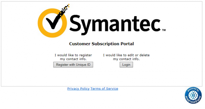

Once you receive credentials, access the Sendwordnow site at https://customerportal.sendwordnow.com/HomePage.aspx
During Open Registration
During some periods there is one extra field required- an Authorization Code.  This Authorization Code, the Unique ID and other necessary credentials are supplied to Premium Support contacts in an introductory email.  You will need these to proceed!

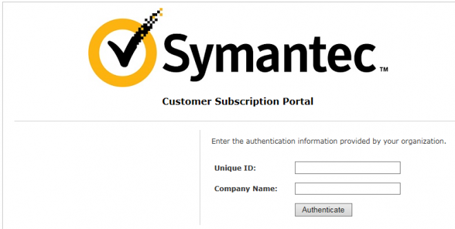

The Sendwordnow site at https://customerportal.sendwordnow.com/HomePage.aspx looks like this during Open Registration: check it out!  An extra field!
Enter in your Authorization Code (if necessary) and you will then be prompted for Unique ID and Company Name.

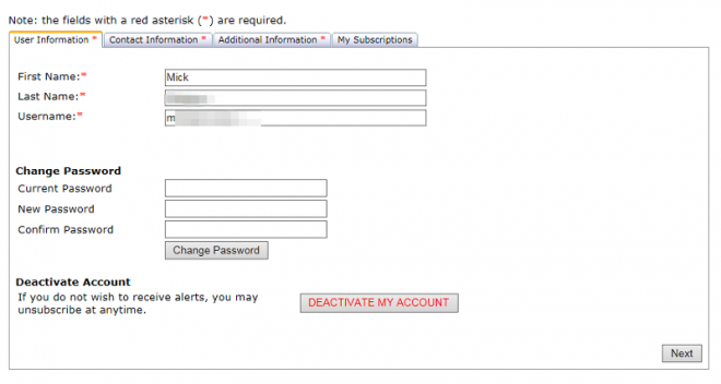

If you did enter a Bieber-related password and need to change it now, there's a convenient input field on the User Information tab:
That page is also the place to click if you no longer wish to receive notifications or alerts.  Simply DEACTIVATE MY ACCOUNT.

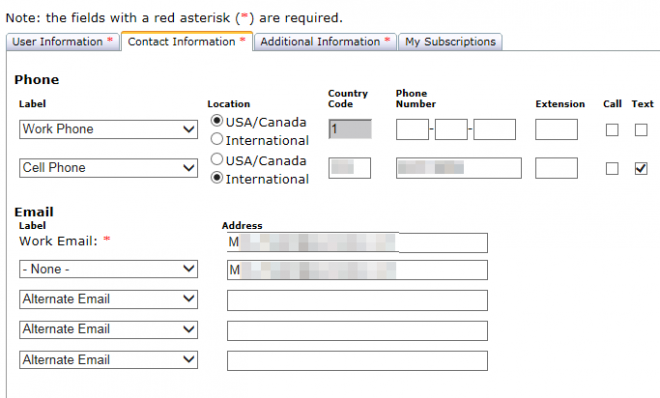

On the Contact Information page, enter in your phone and email details.  You can supply several different numbers and addresses.  For phones, be sure to carefully select call and text, unless you wish the phone to be ringing in the middle of the night!

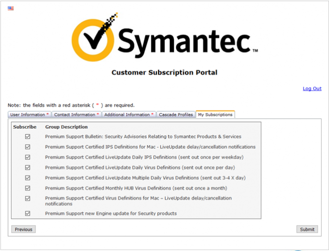

And on My Subscriptions, choose what sorts of notifications and alerts you wish to receive.  Here's an example of what material a Symantec Endpoint Protection (SEP) admin might find interesting (updated, 2018!):
That's it!  Once you hit the Submit button on the completed form, you're ready to rock and roll.  Later, log back into the portal to view or make any changes.
