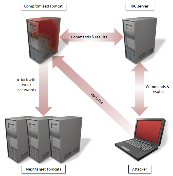

Figure 1. How Java.Tomdep spreads
The Java Servlet is executed on Apache Tomcat, but it does not create a Web page and instead behaves as an IRC bot. It connects to an IRC server and performs commands sent from the attacker. End users who visit Web pages from the compromised Tomcat server are not affected by this threat. Aside from standard commands such as download, upload, creating new process, SOCKS proxy, UDP flooding, and updating itself; compromised computers can also scan for other Tomcat servers and send the malware to them. It is thus possible that DDoS attacks from the compromised servers are the attacker’s purpose.

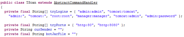

When it finds another Tomcat server, it first attempts to log in with the following pairs of weak usernames and passwords:
Figure 2. Usernames and passwords used in attempts to log in by Java.Tomdep

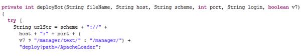

Then it deploys itself to the found Tomcat server:
Figure 3. Java.Tomdep deploys to the found Tomcat server
