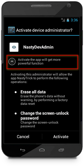

More aggressive techniques depend on a little social engineering to convince the user to activate the app to be a device administrator. In the past, this was done by the app showing the system device administrator activation dialog with a misleading description (Figure 1). This privilege escalation enables the app to lock the device screen, reset the device PIN, or perform a factory reset. Additionally, it prevents the user from uninstalling the malware, either through the user interface (UI) or through a command line interface. These more aggressive techniques, added to the ability to encrypt files, may make all the difference for attackers when it comes to extorting payments from victims.
Figure 1. Administrator activation dialog with misleading description
