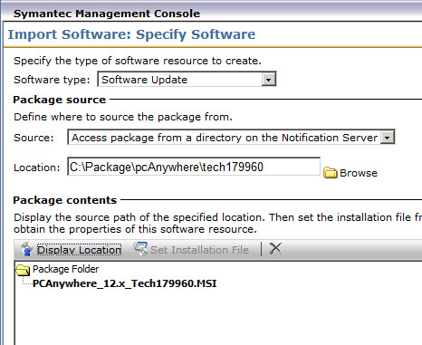

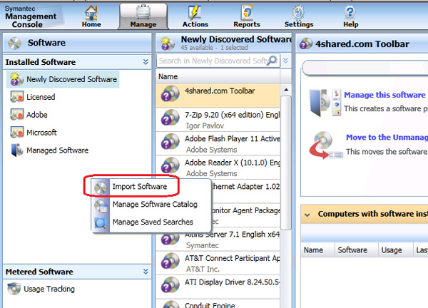

  1. In the Symantec Management Console, browse under Manage > Software > and in the upper right pane right-click in the white space and choose Import Software:
    Or, if you are running version 7.0, browse to Software > Software Catalog > Deliverable Software > Updates and Service Packs then click Import.
  2. In the next screen, change the Software type to: Software Update.
  3. (Disregard this step if you are using your own Package settings) Change the Package Source to "Access package from a directory on the Notification Server".
  4. Browse to the location you placed the patch MSI.
  5. Click Display Location to ensure the Package is properly defined, as shown:
  6. Click Next.

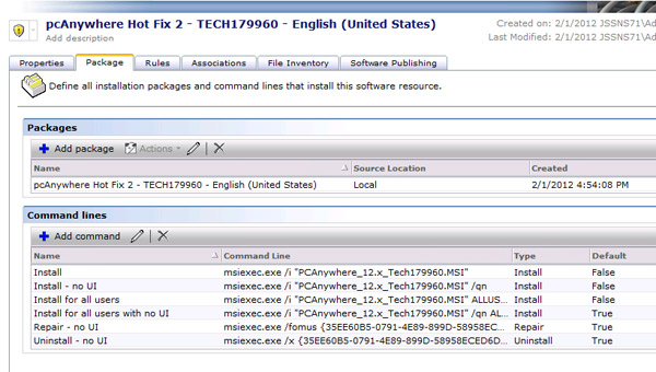

  9. In the resulting window, click on the Package tab.
  10. Within the Package tab all standard command-lines will have been auto-generated by the import. Typically you'll want to use the "Install for all users with no UI" to ensure the update does not interrupt end-users.

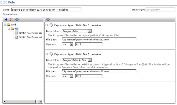

  13. Back at the Rules tab click the New icon next to Applicability Rule.
  14. Provide a name, such as "Ensure pcAnywhere 12.5 or Greater is installed".
  15. Click the blue + icon (add Rule) and choose Operator > Or.
  16. Right-click on the added Or operator and choose Add > Smart Rule: Static File Expression.
  17. Provide the following details:
    1. Base folder: ProgramFiles
    2. File path: Symantec\pcAnywhere\awhost32.exe
    3. Version: >= 12.5
  18. Click OK to add the rule.
  19. Right-click on the added Or operator and choose Add > Smart Rule: Static File Expression.
  20. Provide the following details:
    1. Base folder: ProgramFiles (x86)
    3. Version: >= 12.5
  21. Click OK to add the rule, as shown:
  22. Click OK to apply the Rule to the Resource.

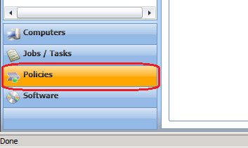

  1. Back at the main Symantec Management Console, click the Policies link in the lower left, as shown:
    Or , if you are using version 7.0, go to Manage > Policies.

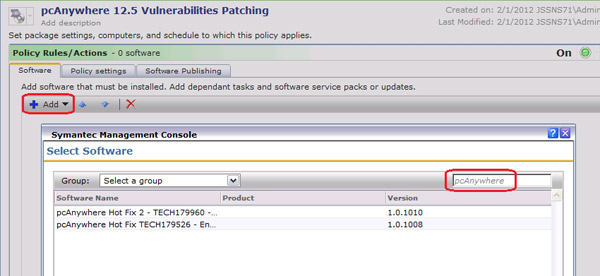

  7. Under the section Policy Rules / Actions click Add > Software Resource.
  8. In the search field, find the first Software Resource by typing pcAnywhere, as shown:
  9. Select the resource named pcAnywhere Hot Fix 2 - TECH179960 - English (United States).
  10. Click OK to add this resource to the Managed Delivery Policy.

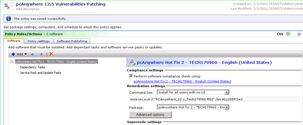

  11. You should now see the patch in the list, as shown in this screenshot:

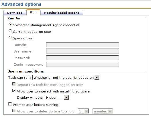

  12. Select the update in the list and click the Advanced options button.
  13. Click on the Run tab.
  14. It is recommended to use the following settings:
    1. Run as > Symantec Management Agent credential
    2. Task can run: Whether or not the user is logged on
    3. Allow user to interact with installing software (checked)
    4. Display Window: Hidden.
  15. All other settings in these tabs can be left at the default.
  16. Click OK to apply any changes.

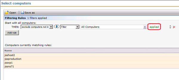

  17. Down below the Policy Rules / Actions section, expand the Applied to section by clicking on the down arrow at the far right of the section bar, as shown:
  18. Click the Apply to button and select Computers.
  19. Click the Add rule button.
  20. Change the THEN: dropdown to "exclude computers not in".
    Note: The label above this section: Start with all computers:... necessitates the use of the double-negative. It makes logical sense, although it is not intuitive.
  21. Leave the middle qualifier as "Filter" and use the search dropdown to find "All Computers".
  22. Click the Update results button to ensure the filter was properly applied, as shown:
  23. Click OK to apply the new filter of computers.

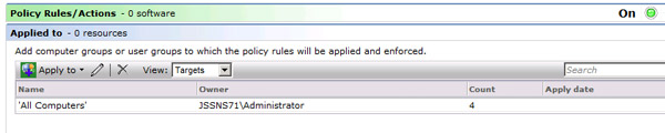

  24. Back on the main policy page it will show a row, including a Count. This count should be equal to the number of Windows systems managed by the Symantec Management Platform:
  25. NOTE! There are other filters that can be used, based on your environment. For example you may already have a filter that contains all systems that have the pcAnywhere agent installed, so that filter can be used in the same manner as All Computers. The reason I am not particular about who is targeted is the Applicability and Detection Rules we added to the resources. If a system does not have the pcAnywhere agent, the applicability rule will stop the remediation action from firing.

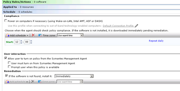

  26. Next, click the dropdown arrow next to the Schedule section.
  27. The first schedule is for the detection check and download (if the detection check determines that the patches are required). As this is a Managed Delivery Policy, you can set the compliance check to a repeating schedule to ensure your systems stay in compliance with the patches.
  28. Click Add Schedule under the Compliance section, and choose Scheduled Time.
  29. Set the time for a reasonable time where the systems can be patched. Since we will be using the silent switch, I'm setting this example at Noon (12:00). Note that the time is in military time, so schedule accordingly.
  30. Click on the link labeled "no repeat" and choose Day from the resulting list. Note again that this will only run the detection check repeatedly, and after the first time it will be found in compliance, unless the system has had the patch removed wherein it will run all checks and install accordingly.
  31. Keep the option checked "Allow user to turn on policy from the Symantec Management Agent". It useful to have this policy in the UI.
  32. For this example I'm leaving the remediation where the patches are applied to "immediately". A secondary scheduled time can be added if you wish the detection check and download to occur at a different time than the patch executions.

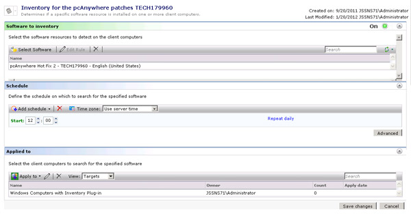

  4. Provide a Name, such as: Inventory for the pcAnywhere patches TECH179960.
  5. On the Software to Inventory bar change the status from Off to On.

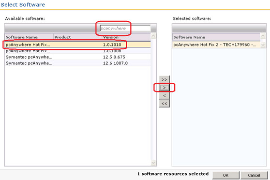

  6. In the section below, click on Select Software.
  7. Use the search field to find the Software Resource we created and add it as shown:
  8. Click OK to save the selection.
  9. Below the Software to inventory section, expand the Applied to section by clicking on the down arrow at the far right of the section bar.
  10. The default filter used for these policies is all systems that have the Inventory Plug-in Installed. This usually suffices, but if you want to add your own filter, see this example:
  11. Click the Apply to button and select Computers.
  12. Click the Add rule button.
  13. Change the THEN: dropdown to "exclude computers not in".
  14. Click the Update results button to ensure the filter was properly applied, as shown:
  15. Click OK to apply the new filter of computers.
  16. As previously mentioned there are other filters that can be used, based on your environment.
  17. Next, click the dropdown arrow next to the Schedule section.
  18. Click Add Schedule and choose Scheduled Time.
  19. Set the time for a reasonable time where the systems can be inventoried. Since this is a very non-intrusive inventory (scans the one detection rule) I'm setting this example at Noon (12:00). Note that the time is in military time, so schedule accordingly.
  20. Click on the link labeled "no repeat" and choose Daily from the resulting list. This will give you frequent data so you can be up to date on what systems have or do not have this patch applied.
  21. The Policy should now be complete, as shown:
  22. Now targeted systems will run this inventory once daily to check and see if the fixes are applied.

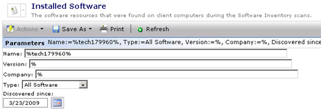

This report works best if you are using 7.1 SP2. He following steps walk through how to find, configure, and run this report:
  1. In the Symantec Management Console browse under Reports > All Reports > Discovery and Inventory > Inventory > Cross-platform > Software\Applications > Software > and select Installed Software.
  2. In the parameters section, use the following:
  3. Name: %tech179960%
    1. Version: %
    2. Company: %
    3. Type: All Software
    4. Discovered Since: wind this back several years to ensure the report provides all data.
  4. Click the Refresh button to run the report.
  5. The row that returns can be double-clicked on (or right-click option) to drill down and show all systems that now have this patch applied.
