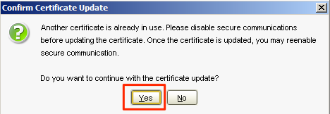

10. Click 'Yes' to confirm the certificate update:

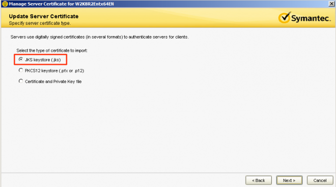

11. Select 'JKS keystore' as the server certificate type:

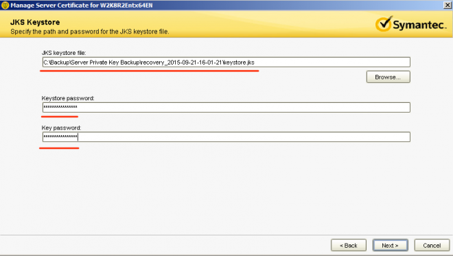

12. Unzip the recovery_xxxx-xx-xx-xx-xx-xx.zip under the backup folder, open the settings.properties with notepad, copy the value of the keystore.password:
13. Select the JKS keystore file under the backup folder, and paste the password into the 'Keystore password' field and 'Key password' field:

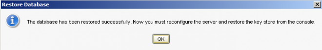

15. Restore the database by running the 'Database Backup and Restore' tool:
16. Restore the database that backup on step 1:

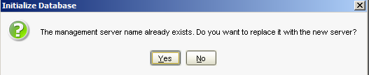

18. During the reconfiguration, click 'Yes' to replace the management server name:
