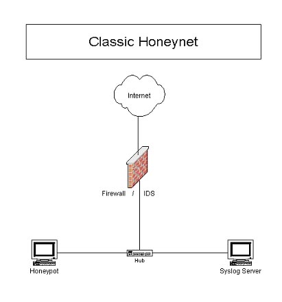

A honeynet is a tool that can be used to learn about the targets, methods and tools used by intruders when compromising a system, it consists of a network of production systems that are designed to be compromised. What makes a honeynet different than the more commonly known honeypot is that a honeypot is usually one machine, often with special software like The Deception Toolkit or Specter running on it, whereas a honeynet is a network of computers. The common elements of a honeynet are:
- A firewall computer, which logs all incoming/outgoing connections and provides NAT service and some Denial of Service protection;
- An intrusion detection (IDS) computer. The IDS box is sometimes on the same box as the firewall, but it should be on an entirely separate computer that can see all of the network traffic. It also logs all the network traffic and looks for known exploits and attacks;
- A remote syslog computer. The honeypot is slightly modified so that all commands an intruder would use are sent to syslog. Syslog is then set to remote log to our remote syslog box; and,
- The honeypot itself. Our honeypot can be anything from a default Redhat 6.2 installation to a mirror of one of our production systems. When setting up the honeypot we want to make as little changes to it as possible. Any changes made could tip off an intruder that this is a honeynet.
A honeynet is a very valuable tool for research, intelligence and education: by knowing the methods an intruder uses we can better detect break-ins in the future. Information gathered from honeynets casn be analysed to monitor attack trends. The information collected from a honeynet can also be used to educate people. For instance, log entries that are a result of a break in can be shown to other system administrators so they will know what to look for. It will also provide users with a picture of what kind of attacks are going across their network.
Figure 1: A Classical Honeynet
