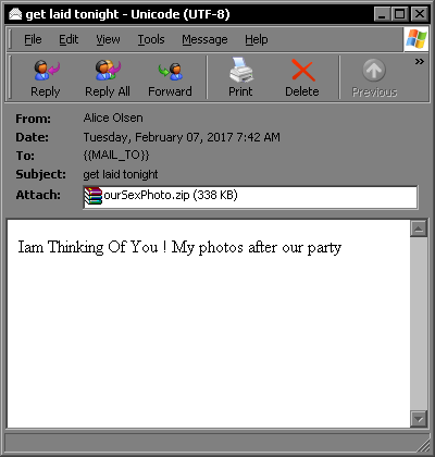

The threat arrives on compromised computers as a .ZIP file attached to sexually explicit spam emails, as shown in Figure 1.
Figure 1. Sample of a sexually explicit spam email containing the malicious attachment

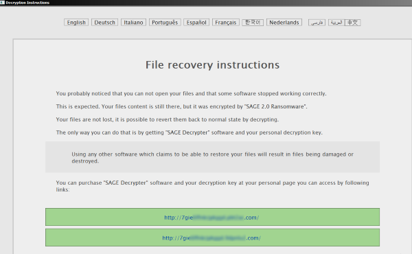

Sage 2.0 also has some new routines that remind us of Cerber, such as offering multiple-language support in its ransom note.
Figure 2. Sage 2.0’s most recent ransom note is an .HTA file with multiple-language support
Like Cerber, Sage 2.0’s ransom note is now an .HTA file that offers multiple language support, whereas it used to be an .HTML file. To be fancier, it also added new default icons for .HTA and .SAGE files in the registry. The .HTA file is displayed with a key icon and contains the ransom note, while the .SAGE file displays a lock icon and holds the locked files.
