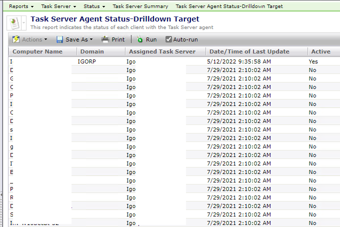

    1. There is a default "Task Server Summary" report where you will all existing Task Servers and how much clients are assigned to each Task Server.
    When double click on required row in this report, then drill-down report will be shown with all assigned client computers and their status of "Client task agent"
    Note: this drill-down report also includes unmanaged computers

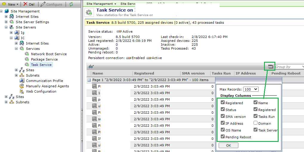

    Or You can open Site Server Management page, click on required Task Server > add additional columns to see agents status, registered, etc (Note that this grid also shows not only managed client computers but also unmanaged computers where SMA isn't installed)
