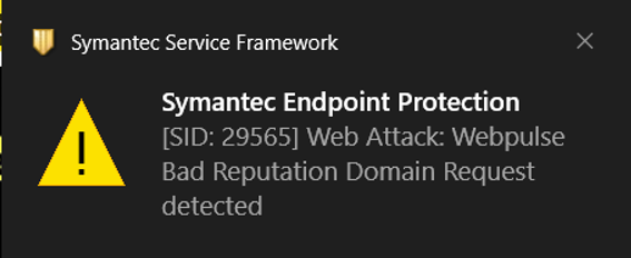

    Since yesterday I'm keep getting the popup from Symantec Endpoint protection
    [SID:29565] Web Attack: Webpulse Bad reputation Domain request detected.
    I ran a Active scan but nothing was found. I also reinstall chrome and deleted all temp files, but still I'm getting this popup after like every 5 minutes.
    Also there are no detail about this like which process is requesting for this domain, I searched all logs in the view log section of Symantec Endpoint Protection but there is nothing.
    Can anyone please tell me how can I find which process causing this alert so that I can delete/stop it.
    Thanks

    the best way to see Intrusion Detection Logs is on the SEP Manager: Monitors - Logs - Network and Host Exploit Mitigation and make sure to select Attacks.

    This is a URL Reputation detection.  Jarkom is correct view the logs on the SEPM.  Once you have the URL and if it is not malicious you can add a Trusted Web Domain exception to stop these.
