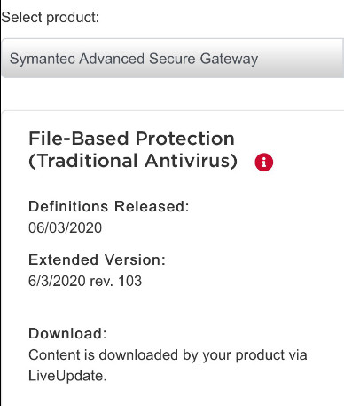

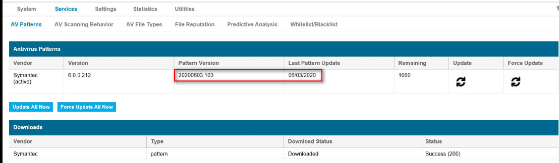

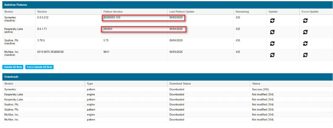

             I think the overview dashboard of part AV & Malware database show message "warning" because only symantec av of last version pattern updated date was late than present time. We tried to change activate to kaspersky av, the dashboard was normal state. If we revert to symantec av, have the same issue.
             We checked the both 2 boxes of ASG and on website broadcom symantect virus definations & security, the symantec av pattern was the same version.
    ref: https://www.broadcom.com/support/security-center/definitions?pid=5aa80d2f72a8e
    On broadcom symantect virus definations & security site:
    On ASG1 (Activate symantec av, the dashboard AV & Malware database show status "warning"):
    On ASG2 (Activate kaspersky av, the dashboard AV & Malware database show status "OK"):
