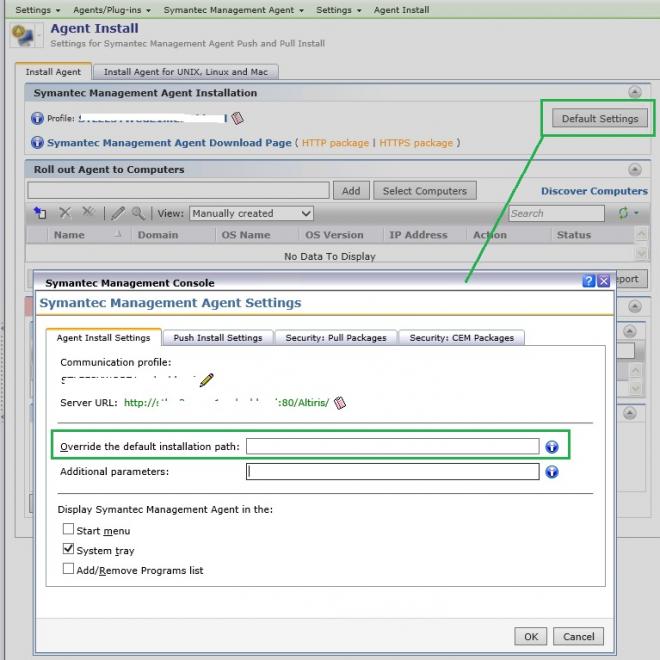

    For Symantec Management Agent installation path, you can set required install directory from "Agent Install" page. Click on "Default Settings" button above, specify install path and click OK, then NS will re-generate "Symantec Management Agent" installation package which is located in \\Your SMP Server Address\NSCap\bin\Win32\X86\AeXNSCHTTP.exe or AeXNSCHTTPs.exe. So you can manually take this installation package and install it or install SMA from "Agent Install" page by push, new changed install path will be used.
