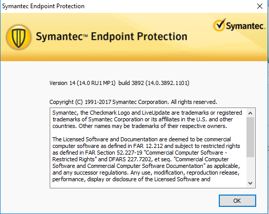

  • 5.  RE: Endpoint Protection Not Working - Yellow Exclamation Mark - Not Opening
    Posted Mar 13, 2018 03:57 AM
    Upgrade was successfull, it says 14.0.3 in the About Section

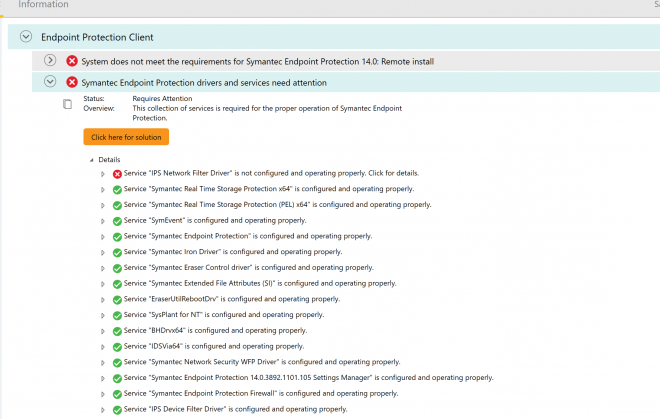

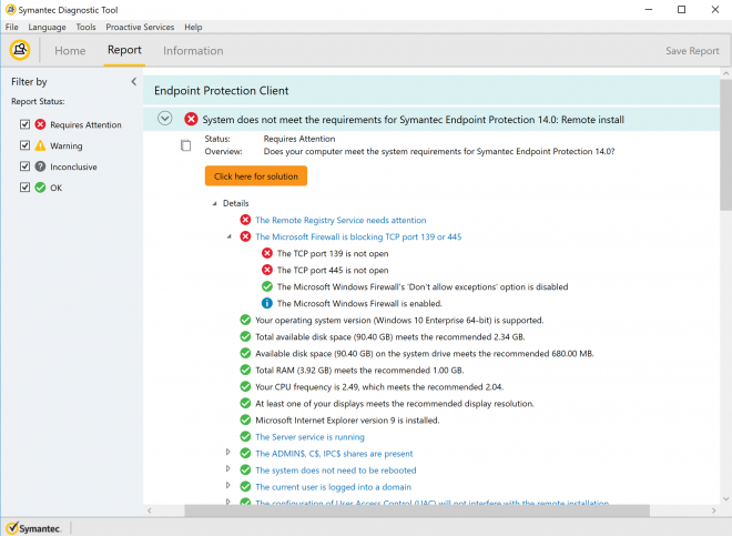

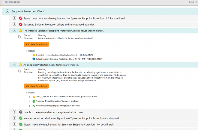

  • 9.  RE: Endpoint Protection Not Working - Yellow Exclamation Mark - Not Opening
    Posted Mar 14, 2018 10:45 AM
  • 10.  RE: Endpoint Protection Not Working - Yellow Exclamation Mark - Not Opening
    Posted Mar 14, 2018 10:50 AM
    @Brian
    After deploying out the updates to 500 machines, only few machines are getting this issue.
    Any suggestions/solutions?  Rebuilding those machines work, but that's not a solution.
    Thanks in advance.
