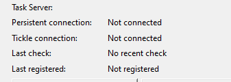

Hi Hagai!
Well, impossible to understand what is going on there and why something fails, if no logs shown for errors/warning messages on such affected Task Servers.
Logs location: C:\ProgramData\Symantec\Symantec Agent\Logs\
Thanks,
IP>

Hi Experts,
I noticed a few targets have not registered to any Task Server.
However, they are all green, all plugins installed, and i dont see any network issues, or any TS configuration issues.
is there a way to force a machine to register to a Task Server?
tnx,
Hagai
