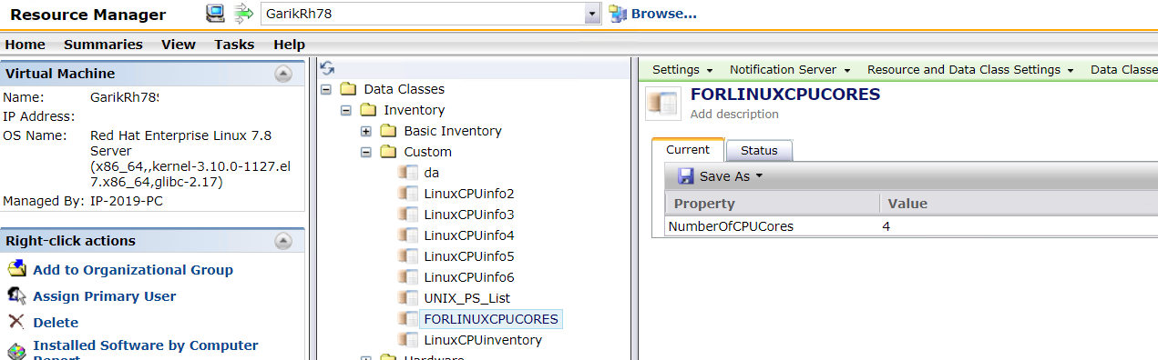

System default data classes can't be used for custom inventory
Better to create own custom Data Class like on pic below

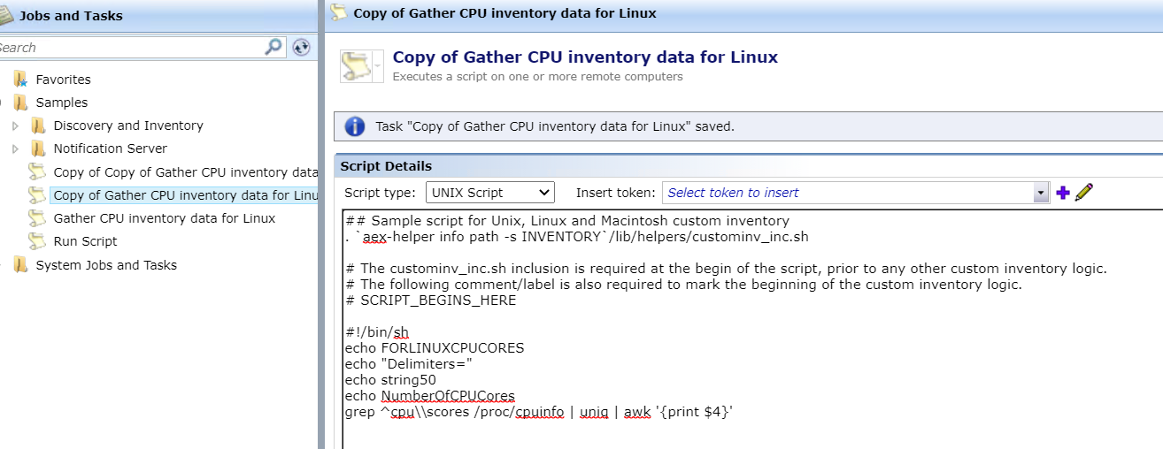

Create Run script task, choose there UNIX script and put this
## Sample script for Unix, Linux and Macintosh custom inventory
. `aex-helper info path -s INVENTORY`/lib/helpers/custominv_inc.sh
# The custominv_inc.sh inclusion is required at the begin of the script, prior to any other custom inventory logic.
# The following comment/label is also required to mark the beginning of the custom inventory logic.
# SCRIPT_BEGINS_HERE
#!/bin/sh
echo FORLINUXCPUCORES
echo "Delimiters="
echo string50
echo NumberOfCPUCores
grep ^cpu\\scores /proc/cpuinfo | uniq | awk '{print $4}'
After task is executed on client PC, this data will be available

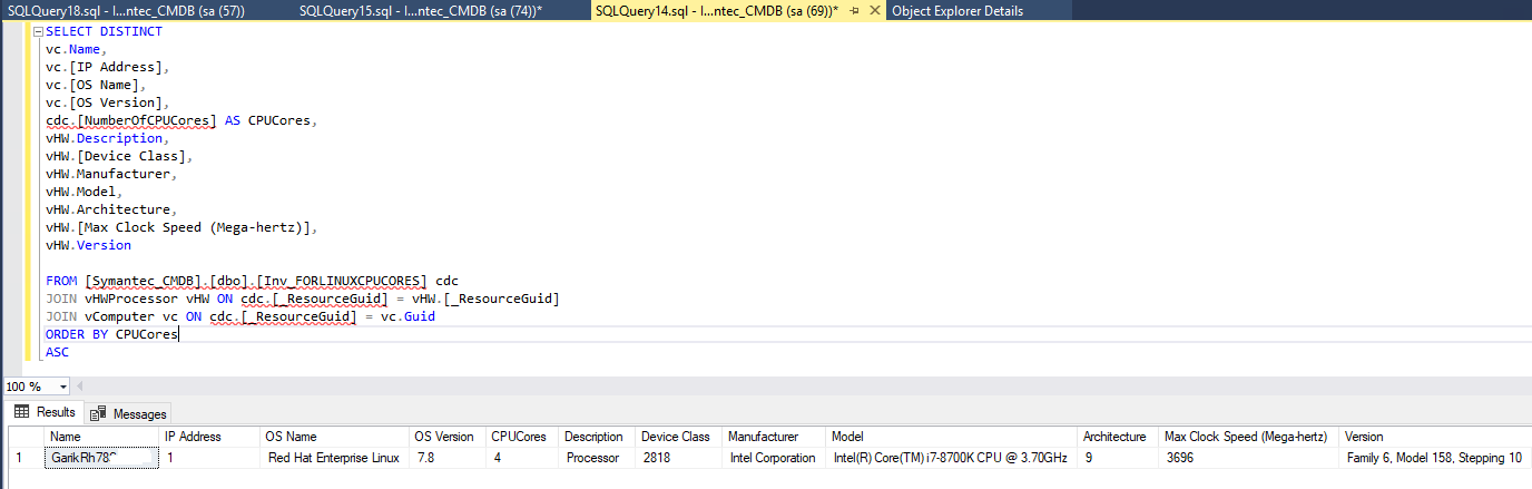

Using custom Data Class and other default data classes, you can combine and create own custom report to include there information about CPUCores amount (In this report will be shown computers which have data in custom data class so all others will not be shown)
For example
SELECT DISTINCT
vc.Name,
vc.[IP Address],
vc.[OS Name],
vc.[OS Version],
cdc.[NumberOfCPUCores] AS CPUCores,
vHW.Description,
vHW.[Device Class],
vHW.Manufacturer,
vHW.Model,
vHW.Architecture,
vHW.[Max Clock Speed (Mega-hertz)],
vHW.Version
FROM [Symantec_CMDB].[dbo].[Inv_FORLINUXCPUCORES] cdc
JOIN vHWProcessor vHW ON cdc.[_ResourceGuid] = vHW.[_ResourceGuid]
JOIN vComputer vc ON cdc.[_ResourceGuid] = vc.Guid
ORDER BY CPUCores
ASC
