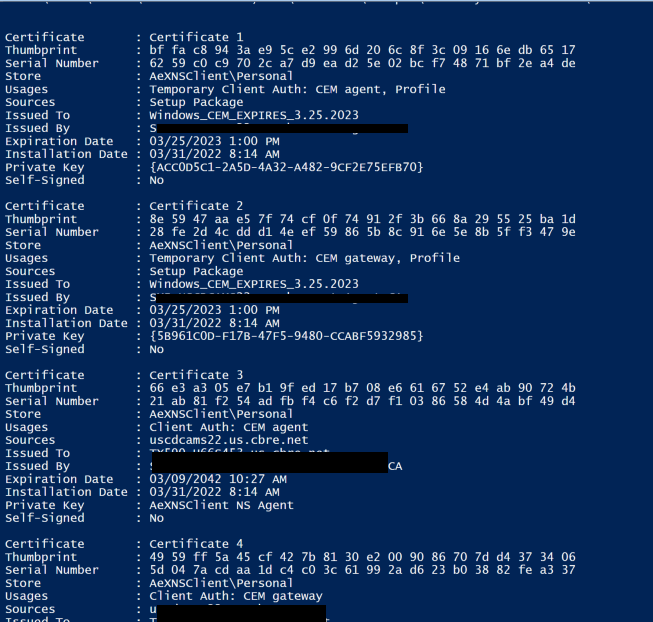

    I know I'm extremely late to the party on a response. I found this post helpful and wanted to share another version of this script that's a little more optimized and might be helpful to someone looking to output the Altiris Agent CEM certificates....

    Below is screenshot of the script output...
