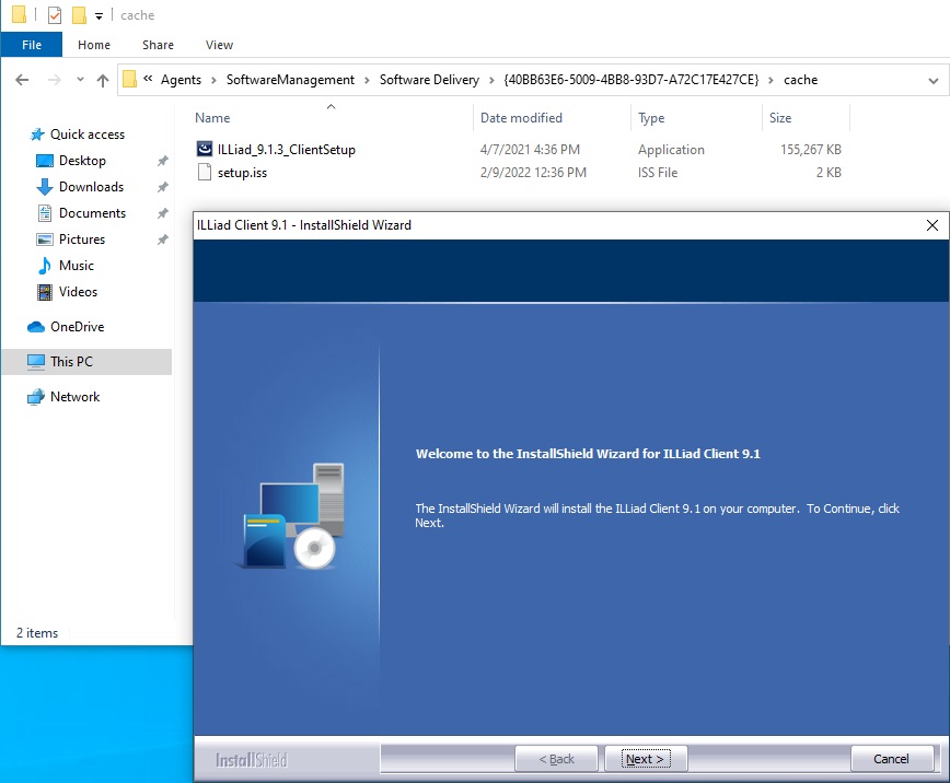

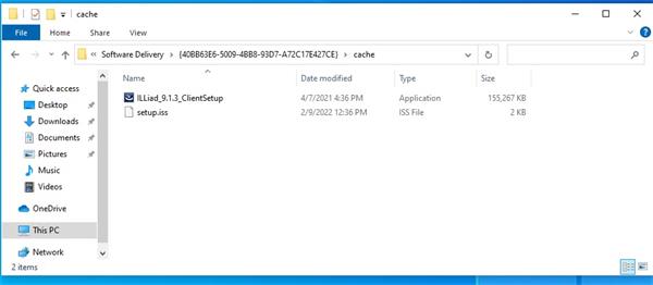

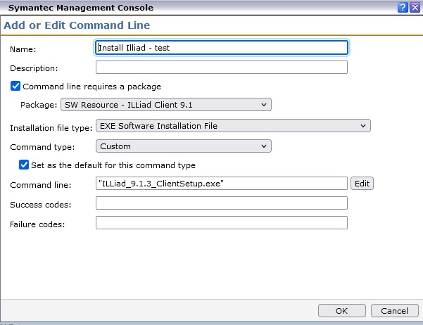

    I have tried just about switch combination that I know of. I can get it to work at the PC itself.
    SW Resource - "Illiad Clientsetup"
    Package;
    -Illiad_9.1.3_ClientSetup.exe
    -setup.iss
    command line for package delivery task;
    Illiad_9.1.3_ClientSetup.exe /s
    When pushed;
    Return Code -3
    This command line works in a dos window from the SoftwareDelivery\{xyz}\cache on the PC.
    PD works with command line;
    How do I get it it pick up on the .iss, please?

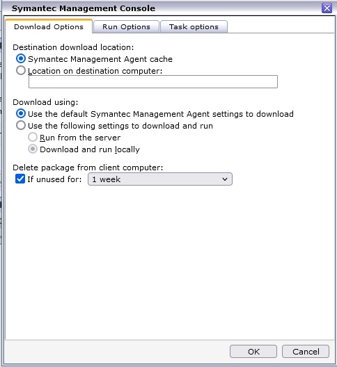

    If I use Location on destination computer in the Advance settings, then the install works.
    To troubleshoot the issue, I changed these settings under the Advance settings:
    Download Options tab:
    -Destination download location
    --Symantec Management Agent cache
    Run Options tab:
    -Check Allow user interaction
    --Display window: Normal
    I got the message "Unable to read file:<path to file>". Maybe you are experiencing the same thing. Also, do not use any switches or parameters, just set the commandline to execute the .exe file itself.

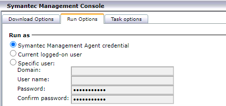

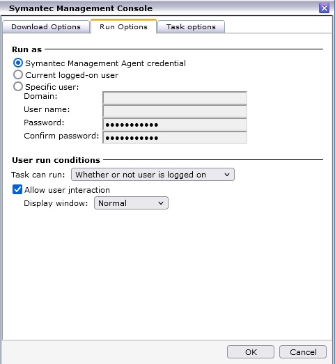

  • 5.  RE: package delivery task - setup.exe with .iss ?
    Broadcom Employee
    Posted Apr 20, 2022 02:01 AM
    Hello Giles!
    You may try to run the task NOT under system account by specifying currently logged in user or specific user.
    These are selectable in the advanced options of the task
    Regards,
    Artur
    Software Engineer 5
    Broadcom Inc.

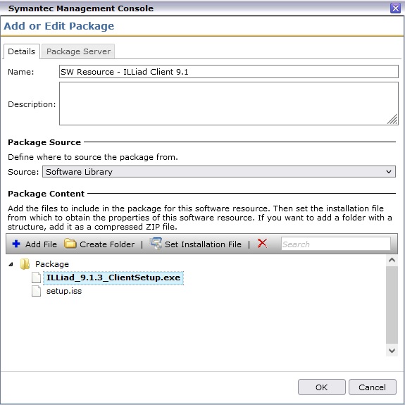

  • 6.  RE: package delivery task - setup.exe with .iss ?
    Posted Apr 21, 2022 08:52 AM
    Hello Artur,
    Thank you for your reply.
    When you mentioned;
    Try Illiad_9.1.3_ClientSetup.exe -s -f1"<FULL PATH TO ISS>"
    what would be the full path, considering this is a package delivery task?
    The SW resource package has both the .exe and .iss in it with the .exe being the highlighted / default.

  • 7.  RE: package delivery task - setup.exe with .iss ?
    Posted Apr 21, 2022 11:36 AM
    Before I would even worry about the path, change the command line to Illiad_9.1.3_ClientSetup.exe. Then configure the Advanced settings as I listed previously. See if the setup even executes or you get an error.
  • 8.  RE: package delivery task - setup.exe with .iss ?
    Posted Apr 21, 2022 12:18 PM
    Edited by Iskyfly Apr 21, 2022 12:29 PM
    Yes the install starts when I am logged in as admin. However, it isnt silent.
    EDIT to add- it also starts when "Current logged-on user" is selected. When that is selected, "Task can run: Only when user is logged on" and "Allow user interaction" is checked and "Display windows: Normal" gets selected by default. Obviously I have to be logged in to see if this works.
    Some screenshots;
    Thank you!
    Giles

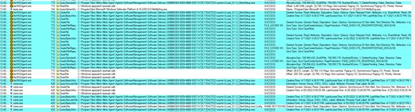

  • 9.  RE: package delivery task - setup.exe with .iss ?
    Posted Apr 25, 2022 01:27 PM
    So you are not having the same issue as I am. While the setup is opened, you can go into Task Manager > Details tab > Right click the Name column > Click on Select Column > Check Command line > Click OK.
    Look at the Command line column and you should see where your exe is executing from. Then you can use that path for you command line.

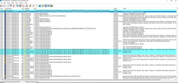

  • 10.  RE: package delivery task - setup.exe with .iss ?
    Posted Apr 25, 2022 01:59 PM
    Thank you for your reply!
    PROCMON shows the following;
    Giles

    In the "Add or Edit Command Line" for a Package Delivery task;
    What is the difference between;
    Installation file type: "InstallShield EXE Installation File" and "EXE Software Installation File" ?

  • 28.  RE: package delivery task - setup.exe with .iss ?
    Posted Apr 27, 2022 04:27 AM
    Installation types - not sure what the difference is except it might offer some intelligence around return codes?
    I've just noticed you said that
    C:\install\ILLiadClientSetup.exe /s /v/qn
    works perfectly. Unless I'm missing something, that isn't using the setup.iss file? Do you change any of the settings when using /r?
    The other thought it's provoked is that if you're adding "/v/qn" to pass to an MSI, can you find the MSI and use that directly instead? Perhaps start the install and use PROCEXP to see where it's unpacking the MSI file to and if there are any **** parameters?
    As mentioned though I have very occasionally seen software that doesn't agree with being installed as SYSTEM due to the lack of much of a user environment.
    Regards
    Martin
  • 29.  RE: package delivery task - setup.exe with .iss ?
    Posted Apr 27, 2022 02:15 PM
    Edited by Iskyfly Apr 27, 2022 02:18 PM
    Thank you for your reply Martin!  Per email conversation between vendor and me they said, and tested, to use /s /v/qn.
    I can take the install .exe and the .iss file and put them in the same directory anywhere on c:\ and run the following manually at the command line;
    C:\ILLiad_9.1.3_ClientSetup.exe /s /v/qn
    It works. I don't know why Altiris can't handle that. I would say the problem is with altiris given that the software installs fine by command line manually on the destination PC. I can't seem to find Altiris documentation on how to syntax an exe install with an .iss.

    Keep in mind that Altiris is a only a messenger and delivery driver. We deliver the package files and then pass on the command line and credentials to run as (default is to run as the Windows System account, what the agent runs as). If it fails, it is either because the package files didn't arrive, because the command line is incorrect, or the credentials are not sufficient.
    When deliveries do not successfully install or run what was intended, there are only a few places to troubleshoot.
    1. Does the package get to the client with all the files intended?
    2. Does the command line start (hand's off to the Operating System - at this point it is out of our hands)?
    3. Is the command line suitable per the vendor (vendor writes the exe and builds any switches)? In your situation, is the ISS file correct? Testing locally helps here before setting up an Altiris delivery.
    4. Does the command session (cmd.exe) open with rights and permissions needed - common issue is you test locally logged in as you, and then leave the default of System (what the agent runs as) in the delivery task/policy, which may not have the rights needed. System as built in is a local administrator with no network rights.

  • 33.  RE: package delivery task - setup.exe with .iss ?
    Broadcom Employee
    Posted Apr 27, 2022 03:30 PM
    Edited by Chris Farrell Apr 27, 2022 03:31 PM
    Hi George - no worries, sounds frustrating for sure!
    So I'm assuming the exe looks for the .iss file since it is not specified in the command line?
    I would test manually again. Copy the command line from Altiris and paste it directly into the command window when in the SW Delivery folder where it has been downloaded to by the agent. If it succeeds, its not the command line - I have seen cases where a double quote is to blame. There are curly double quotes and those will throw an error as they are interpreted as other characters.
    Also, if it succeeds, put your credentials into the SW delivery to run as you (or whatever account you logged in to the client with when it succeeded.).
    All we are doing is opening a CMD.exe process with the rights specified in the task/policy and passing the command line from the SW resource. We don't care about anything else - the fact that there is an .iss file present and involved should not matter. We run the command line in the SW delivery\GUID(PackageID)\cache folder, so as long as all files needed are there its no different than a manual test.

  • 37.  RE: package delivery task - setup.exe with .iss ?
    Broadcom Employee
    Posted Apr 28, 2022 11:01 AM
    I would try adding InstallShield logging to your command line in Altiris.
    /f2"C:\Setup.log"
