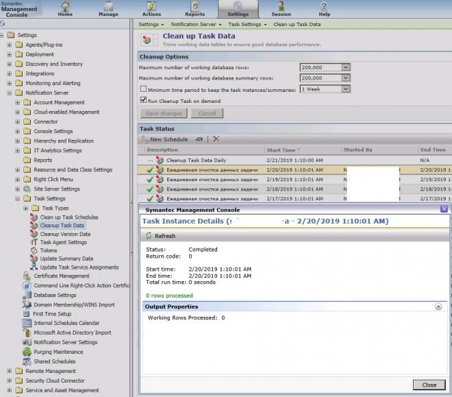

    Mentioned above resolved SQL query from default "Job/Task Status Detail" report already has set parameter to show all available executed jobs or tasks per whole date/time period, even should include 2017 year.
    • You mean if you open "Executed Jobs/Tasks by Filter" report in Console and will set for example value 780 in 'Last N Days' field, then it returns you info about executed tasks in 2017 year?
    Probably task instance(s) execution events were purged already from database. You can check "Clean Update Task Data" task instances which were completed, double mouse click on each completed task isntance to see how much rows were processed (purged)
    Open Symantec Management Console -> Settings -> All Settings -> expand "Notification Server" folder -> expand "Task Settings" folder -> click on "Cleanup Task Data" -> mouse double click on required completed task instance -> check processed rows amount.
