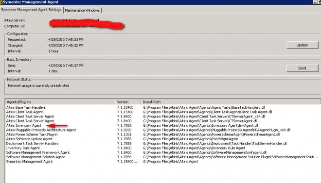

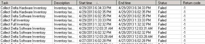

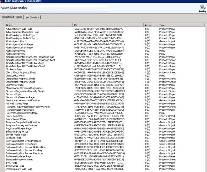

    We recently migrated to NS 7.1 SP1, and are in the process of upgrading clients from NS 6 to 7, while in the course of validation, if agents and plugins are installing correctly - i've come across the above mentioned error (Title) on the NS 7 box itself - where inventory tasks on the agent are constantly failing. I tried to search the community and the KB for any possible solution to re-registed the plugin ( I see it listed in the install path). Below is the exact error and screenshots attached

    Nope, not sure how can i just uninstall inventory plugin alone from the agent, do not see it listed in add/remove programs as well..
