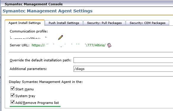

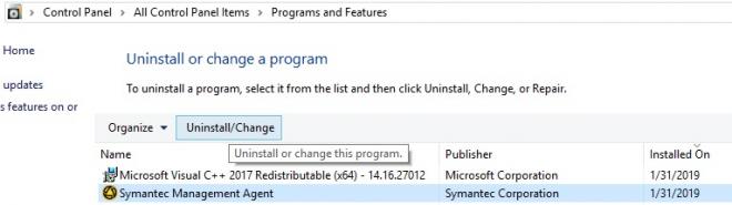

    And If you had checked "Add/Remove Program List" checkbox in Default Settings on "Agen Install" page, before Agent installation on client compouters, then you can uninstall Agent on required Workstations from "Add/Remove Program".
