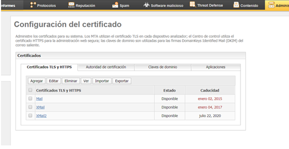

That page would display both TLS (SMTP) certificates and HTTPS certificates so we can't tell for sure from that screenshot.
As tpa pointed out, if the certificate is an https certificate for secure communication with the control center, then it would only be needed to be configured for the control center. You can do that in (Administration > Control Center > Certificates)
My suggestion was for a TLS certificate for SMTP transactions on the scanners. You can configure that (Administration > Configuration > Select a scanner > Edit > SMTP) on the Inbound, Outbound and Authentication tabs.

the certificate soon to expired is this

The general answer is "no", it won't be "automatically" distributed to the scanners.
You know best, but it "sounds" like you are referring to the "server" certificate that is used in the BCC. If this is the case, you wouldn't want that to be deployed on the scanners: it's use is really for browsers to have confidence that they are "really" talking to the BCC and not some spoofed endpoint.
The certificate that gets pushed out to the scanners is the one that you specify for use in SMTP TLS conversations, since THAT is the certificate presented during the TLS handshake phase when someone tries to send email into the SMG using SMTP TLS.
