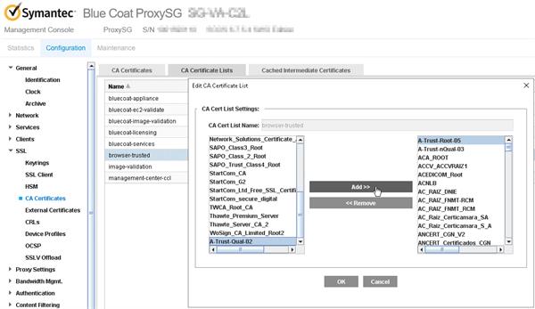

    Hi ITA ISD,
    For Browser Trusted:
    First, make sure you have imported the new certificate under Configuration > SSL > CA Certificates > CA Certificates.
    Once the certificate is imported, navigate to the CA Certificate Lists tab, and click on browser-trusted, and then Edit. Find your certificate, and then click add. close out and hit Apply to save the changes.
    Conversely, for an old certificate that you don't want trusted anymore, find it in the list in browser-trusted and remove it. Afterwords, you can remove it from the CA Certificates list in the first step.
    If you are wanting to remove an old un-used keyring, you will want to use make sure the keyring is not longer referenced in policy or in the configuration. You can see if a keyring is referenced under Configuration > SSL > Keyrings. If something is referenced, usually a look for the keyring in the Sysinfo is the easiest way to see where in policy and config the keyring is referenced. If it is the default keyring, however, it becomes more difficult, as the default configuration is not listed in the Sysinfo. For this case, or if you are not well versed in reading the Sysinfo, I would recommend checking the places listed in this KB.
