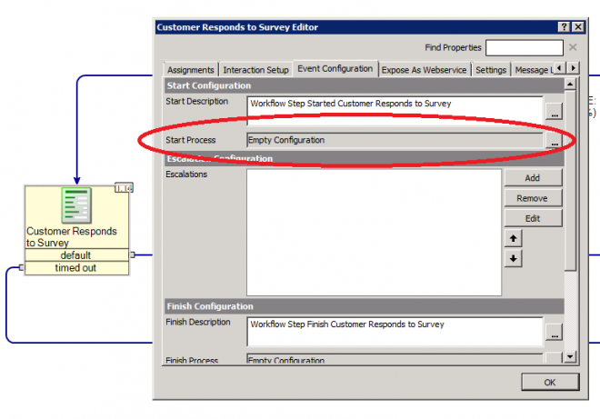

    First, open the task and go to the "Event Configuration" tab and click on the "Start Process" elipses. This model runs when before anything else in this component.

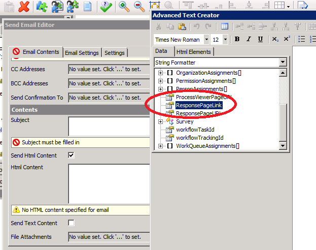

    When you put in a "Send Email" component in here, you'll see you have access to a special variable called "Response Page Link". Drop that somewhere in the body of the email and that should do it (though you might want some additional content, too!)

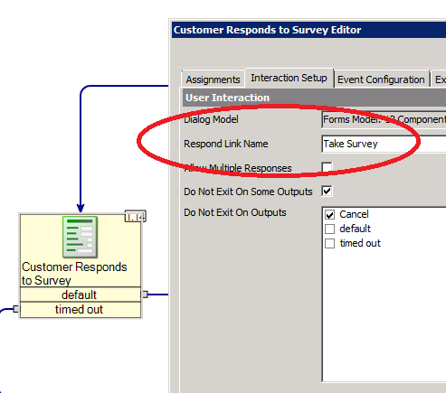

    Now, you may be asking, what does that "ResponsePageLink" variable actually contain? The answer is that it will contain an html link to the survey task with whatever text you choose. By default, the text for the link will be "Take Survey", but you can change that on the "Interaction Setup" tab of the task component.
