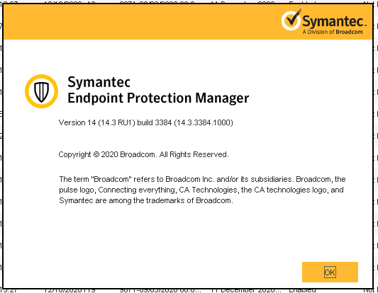

Unfortunately, upgrading our SEP Manager did not fix the problem.
I upgraded our SEP Manager from 14.2 RU2 MP1 to 14.3 RU1 but our MacOS Big Sur clients are still displaying the warning every 10 to 15 minutes.
