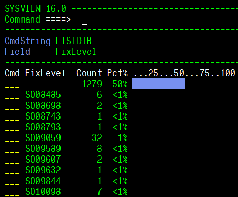

    • The last step is to produce a report of the fix levels (PTF numbers). This can be done by issuing this command from the LISTDIR command:
      UNIQFLDS FIXLEVEL
      A report similar to this will be created:
      The report indicates which PTFs were found to be present on modules in the load library. If a PTF appears in the report list, it means you have it applied and are currently running with it.

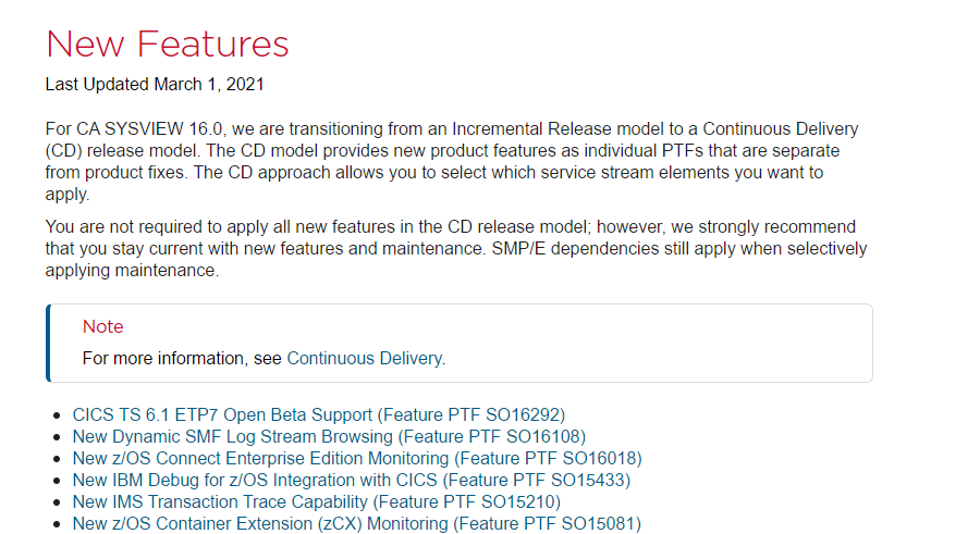

      You can take the output of the report and compare it to the "New Features" page on the SYSVIEW space in the Broadcom TechDocs Portal. Here is a link to the SYSVIEW 16.0 new features page:
      https://techdocs.broadcom.com/us/en/ca-mainframe-software/performance-and-storage/ca-sysview-performance-management/16-0/release-notes/new-features.html
      The above link lists all current feature PTFs in detail by PTF number:
    I should note while this method will be mostly accurate, but it is not 100% fool proof. It is only scanning the load library. A PTF may have only updated other library types aside from the load library (this is very rare). Also, a PTF may have updated the same module that another PTF updated, so that module will only appear with the highest fix level, making it appear you may have one PTF on, but not another (again rare this would be an issue since our feature PTFs tend to update quite a few modules).
