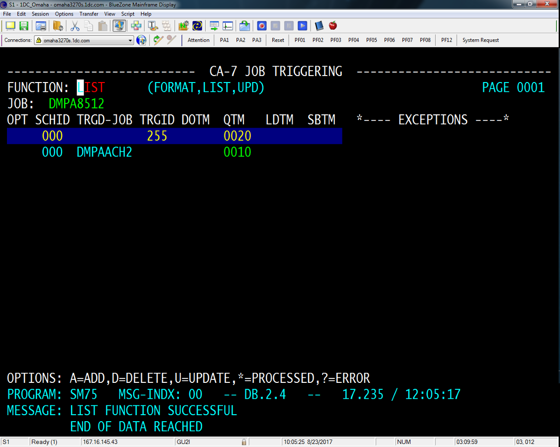

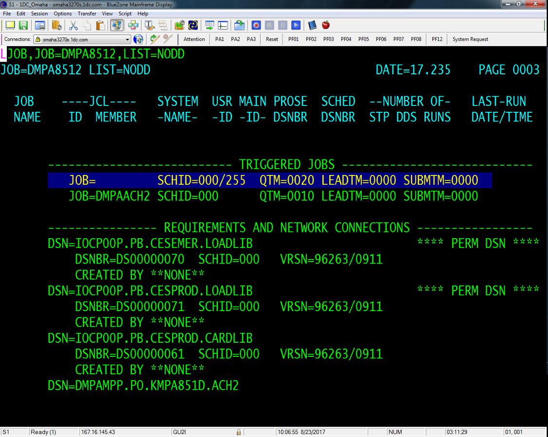

    An Operator was doing an FSTRUC on a job and found a "blank" job. Has anyone seen a "blank" job in CA7? Here are the snapshots:
    FSTRUC screen.
    I did an LJOB and it also shows blank:
    and the SCHD,JTRG also shows a blank:

    By the way, I tried to remove that in the SCHD.JTRG screen and I get an INVALID VALUE: TRGD-JOB

    I suggest you open a case in support and we will help you to 'clean' this entry
