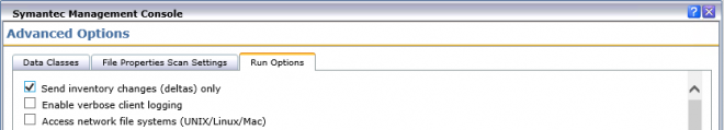

Delta Inventory
This option makes a huge difference on what is sent to the Notification Server. If checked, after data is gathered it will be compared to what has already been sent.
NOTE: Having a policy that sends full data can help avoid situations where data classes are missing altogether, as covered previously.
This is done in the following ways:
  • For the Hardware, Operating System, User, and Server Inventory data classes, the data is checked against what is stored in the NSI fragment files. These are located at C:\Program Files\Altiris\Inventory\NSI. If the data is the same, nothing will be sent up to the server for that particular data class.
  • File Scan data is gathered, and then checked against what is listed in the InvData.mdb database file, located at C:\Program Files\Altiris\Altiris Agent\Agents\Inventory Agent, or C:\Program Files (x86)\Altiris\Altiris Agent\Agents\Inventory Agent (the drive letter may be different if a different install path was chosen for the Symantec Management Agent). Files not previous recorded are compiled into the NSE, and files that have been removed are compiled in a separate NSE. These are then sent as the delta updates to file data.
  • For the Software – Windows Add / Remove Programs option, after the data is gathered it is compared to the softwarecache.xml file, located at C:\Program Files\Altiris\Altiris
Agent\Agents\Software Management\Data. Software both added and removed is compiled into a single NSE to be sent to the Notification Server for processing.

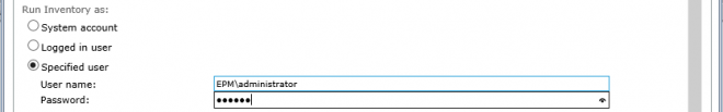

Run Inventory User
Typically this should be left alone. The System account, and the impersonation it is capable of, provides the access it needs to gather the pertinent inventory. There are a few items that may require this to be changed. For example if you want to gather what drives are mapped, and what shares are open for a user the policy needs to run under the Logged in user. Mapped drives are typically user-based, so this would be required to gather this data properly.
Another example is in situations where the System Account has been locked down. In those cases selecting a specified user that has administrator rights on target systems may be required.
