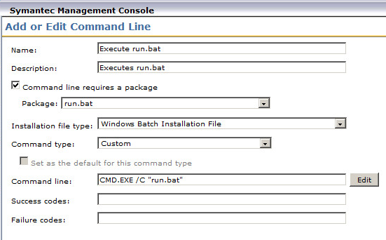

    Posted Aug 11, 2015 07:10 AM
    Please use next Parameters:
  • 10.  RE: How to execute or change registry value

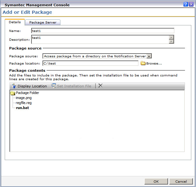

    try this inside of the bat file:
    IF NOT EXIST C:\Windows\System32\oobe\info\backgrounds mkdir C:\Windows\System32\oobe\info\backgrounds
    xcopy /s /y /f /o "%~dp0image.png" C:\Windows\System32\oobe\info\backgrounds
    regedit.exe /s "%~dp0regfile.reg"
    put all files in one directory like that:
    import into one software resource like that:
    Create new Quick Delivery Task, and run it on client.
