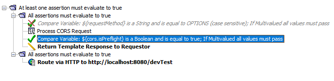

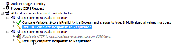

Where we have a setup of :
Effectively "Process CORS Request" is run, then we check if it is a preflight (OPTIONS request) and then returns the allowed CORS settings.  Otherwise we perform the actual GET or POST request.

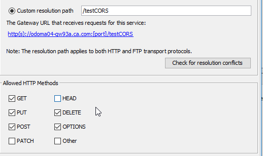

Note: Also remember to allow "OPTIONS" on the service, as it is not enabled by default

In our case we need to handle both CORS and non CORS requests.  So we put the "Process CORS Request" in the branch.
It will try the CORS request, if it succeeds, and then if it is a preflight (OPTIONS) request, then we return the template response, and the CORS assertion will have set the correct headers.
But for all other outcomes, ie, if the CORS fails, or CORS passes but is not preflight.  Then we fail to the other branch and make the backend call.

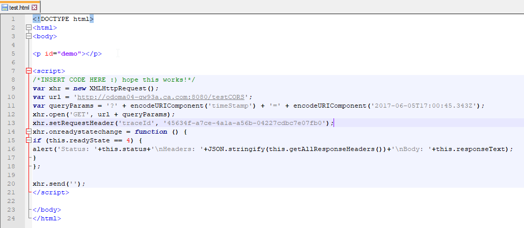

Here we have the API Portal 3.5 generated javascript code, which we've put in a simple test.html page,

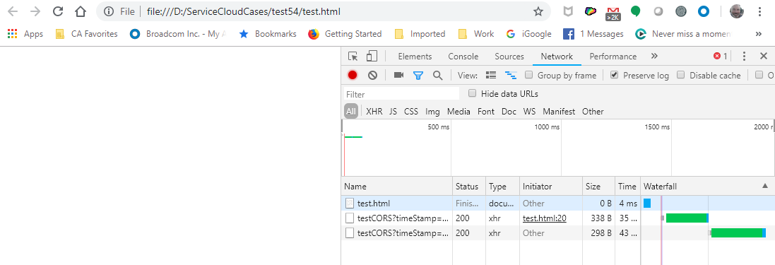

And are running from Chrome, with developer tools, so we can trace the request.   We can see three requests, one for the raw test.html page,  and then two requests for the XMLHttpRequest.  In this case because of the "traceId" header, Chrome has decided it is not a "simple" request so it sends an OPTIONS request followed by a GET request.

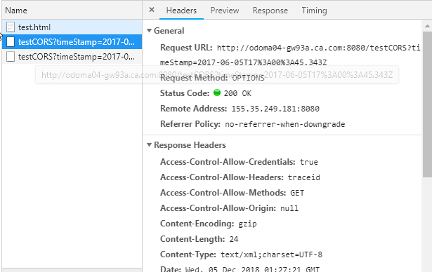

Here is the send and response of the OPTIONS request :
(just a note that Origin: null is what we get for page loaded from local file system, and can be subtly different from Allow-Origin: *)

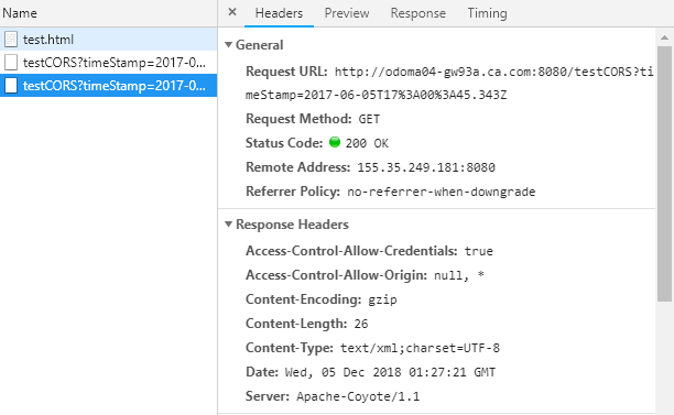

And the second request is the normal GET request that actually retrieves the data :

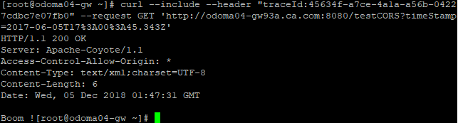

Being simpler, CURL just makes one request, here is us running the command:
And the one entry we get in the Gateway Audit logs:
If we had a vanilla "Process CORS Request" the curl use case would have failed.

But when we go via CORS ie, using the Chrome browser we got back :
This was with API Gateway 9.3 which has merged, the null value since our original request is from "null" (ie a local page) and the response from the backend server which was "*".
I only mention this as on API Gateway 9.2, the merge did not happen and Chrome recieved back two headers ie:
Access-Control-Allow-Origin: null
Access-Control-Allow-Origin: *
And Chrome threw an exception.
In our case we modified the "Route Via HTTP" request to not allow the response header from the backend.  But similar Manage Transport Properties/Headers could be set to leave only one Access-Control-Allow-Origin: header.
