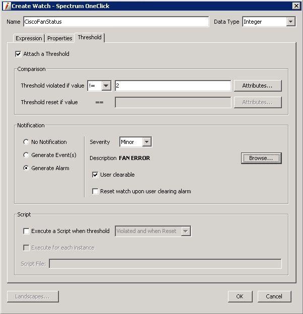

  • On the Threshold tab, select Attach a Threshold
  • If you just want to look for a "not OK" value, you can set Threshold violated if value != 2 (the MIB defines values 2=ok, 3=minorFault, 4=majorFault, 1=other).
  • In the Notification section, you can enable Generate Alarm. You can leave the default description, select an existing one from another alarm or create your own.
  • You could remove the User clearable option in this case, since alarm will automatically reset once the fan status goes back to OK.
  • Your threshold configuration would look something like this then:
