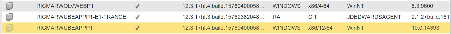

    Hello,
    We have installed a windows+ JDE agent. JDE agent is running fine where as windows agent is not coming online in AWI.
    Settings and configurations seems correct. Have any idea how to fix this issue?

  • 12.  RE: Windows agent not coming up
    Posted Aug 08, 2022 04:36 AM
    Hello,
    Thankyou for your help,
    We have re installed the service manager after that the agent is running fine.
    regards,
    Shravya
